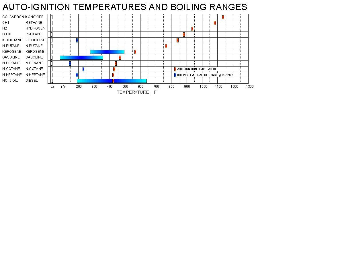

Ron, Great Idea for vaporizing gasoline with boiler steam, without cracking it and causing carbon plugging of the vaporizer tube. One worry point for boats is the flash point of gasoline which is quite low compared to kerosene or Diesel fuel, but then most pleasure boats using IC engines do burn only gasoline.
To apply the same steam heating idea to vaporize kerosene one would need to generate about 600 psi steam, a bit too high for most (but not all) steam engines. A good compromise for kerosene might be to heat the kerosene first with steam, then finish with a small, and straight, vaporizing tube near the furnace. A straight vaporizing tube is fairly easy to dismount and clean out with a rifle bore brush or similar.

- FuelsDistillation-AutoIgnition.JPG (97.85 KiB) Viewed 12224 times
