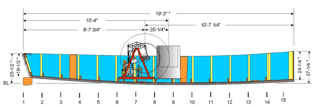

Interior Profile

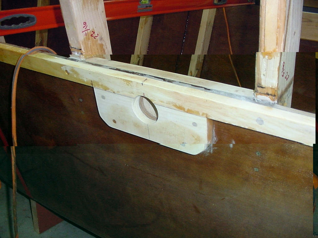

- 1.312 inch diameter paddleshaft will be fitted here.
- PaddleshaftHoleS.jpg (84.52 KiB) Viewed 34659 times
- Inwales epoxied in place, Hull Structure Complete

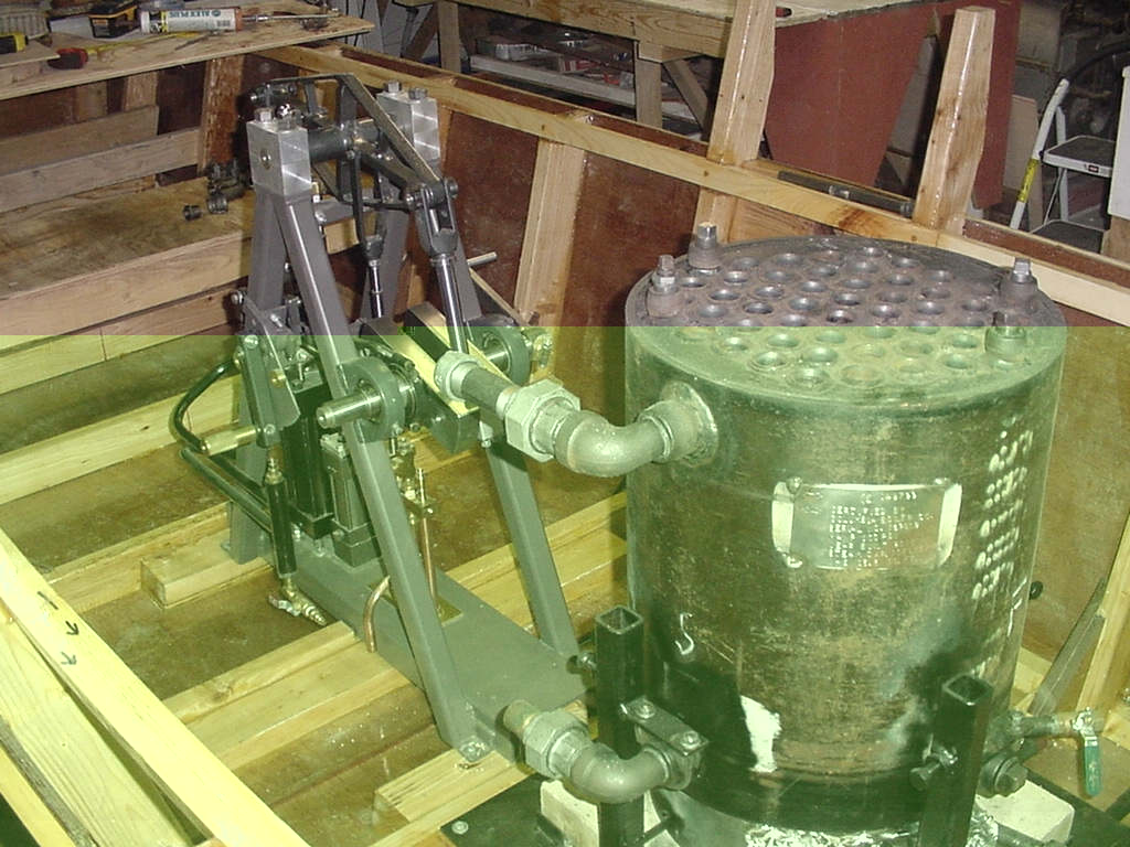

Built the manual feed pump yesterday, welded up a new axle for the trailer today, and mounted the engine this evening. My son is putting in some crude plywood seats and floors, all temporary until the best seating arrnagement is figured out. Shafts and paddlewheels go in tomorrow.
