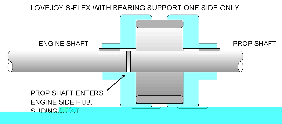

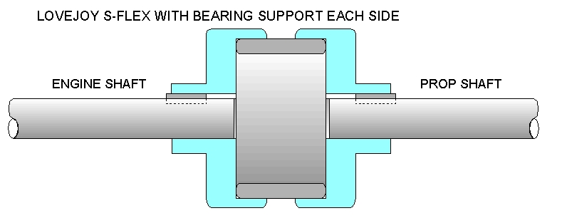

I think I notice a hard coupling between the engine and drive shaft on your setup. I would recommend this be replaced with a torsionally flexible coupling, which will absorb shock if the propeller strikes a submerged object, as well as damping the vibrations mentioned above.. The only practical place I can see to put this is where the hard coupling is presently mounted, the engine output shaft.
The two shafts must be aligned axially. The conventional method is to have another pillow block on the other side of the coupling to maintain alignment of the shafts. Another method is to have the driven shaft enter the hub of the engine side coupling hub, with a sliding fit. The sketch below shows this setup, which is probably the better option for your boat.
CONVENTIONAL MOUNTING BEARINGS NEEDED BOTH SIDES

lovjoy conventional.jpg (62.11 KiB) Viewed 20530 times
EXTENDED SHAFT BETWEEN HUBS, NO NEW BEARINGS
lovjoy AXIS.jpg (92.62 KiB) Viewed 20530 times
