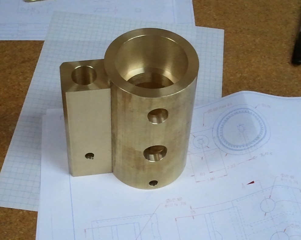

- Colleague Kelly Anderson is machining the engine pumps; see photo of initial bores, attached.

Nice machining job on those pump parts. What service is that pump being used for?

fredrosse wrote:When do you plan to be steaming on the water?
I don't know, Fred, maybe 2015 or so. There's a lot to do and I'm in no rush. The pleasure is in the building of it, and all that ...
fredrosse wrote:Nice machining job on those pump parts. What service is that pump being used for?
Thanks, I'll pass that on to Kelly. It's a crosshead-driven air pump for the condensor, with a feedwater pump on the left; standard LP engine mounting.

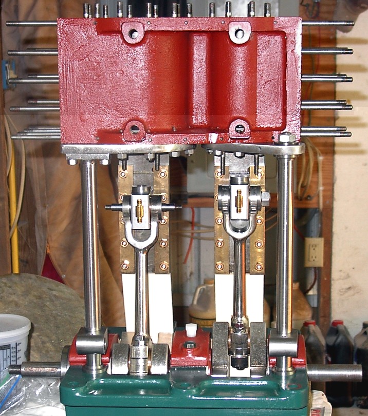

Engine erection so far ...

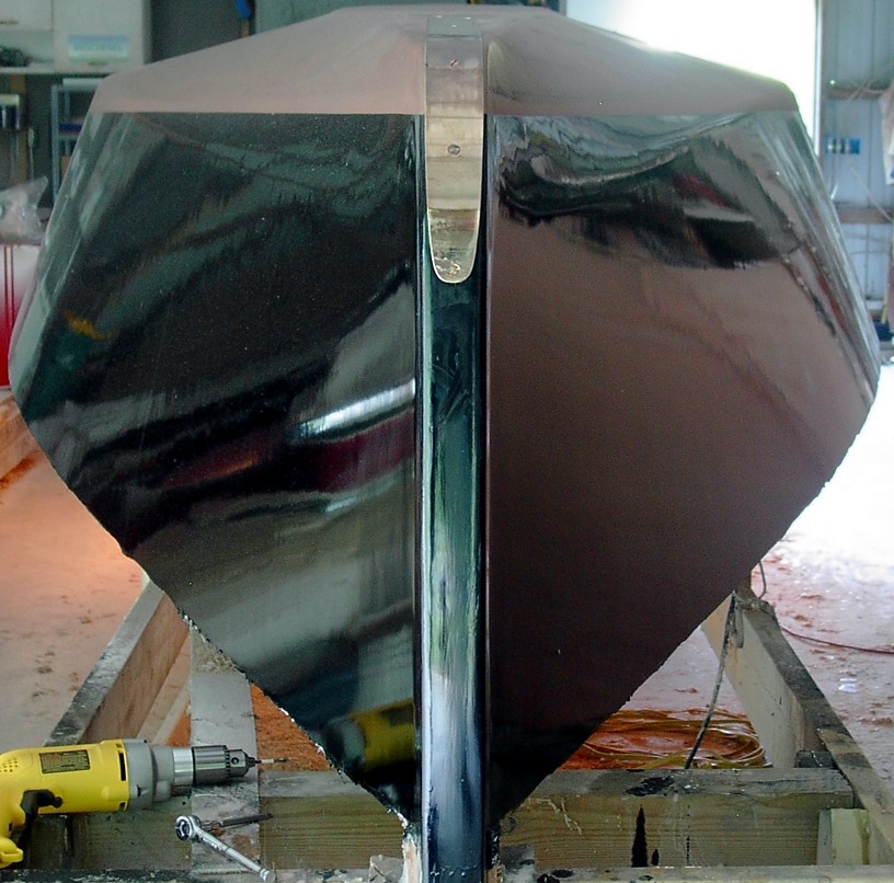

Adding the silicon bronze bow and keel guarding ...

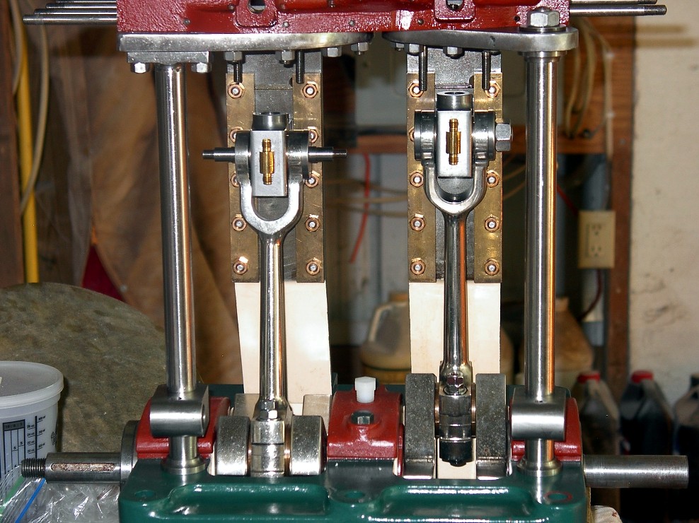

Con rod and crosshead detail ...
Re: My 24' Launch
Looking good there Steve, she's going to be a real beauty.
