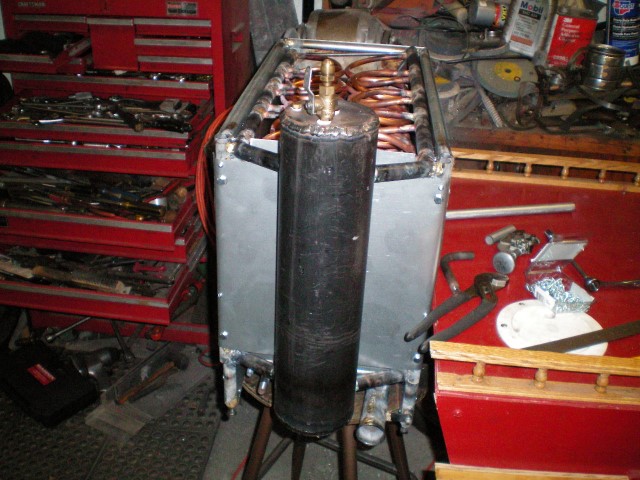

Planning to do the same to the tug. I'm sold on Ofeldts. My buddy builds them with copper coils and they do just fine - gasoline fired. Brazes the copper to steel nipples in the center drum.
He came up with a new boiler design based on the Ofeldt, so far, so good. It results in a square boiler, would be great for a steam bike. Two sets of high and low headers that the coils connect to.
PS I know that head is not fitted correctly to that drum and he and I go around and around about it.

Your friend's boiler looks similar to a Blackstaffe Boiler, but with a vertical drum.

I find those photos terrifying. I can't imagine doing any repairs. I sometimes think of a water tube boiler as a future replacement for my VFT if it ever comes to that but the complexity is very daunting.
To quote Captain Ball in one of the Glencannon episodes, it's a enough to give you, ". . . the wahwahs complete!"
