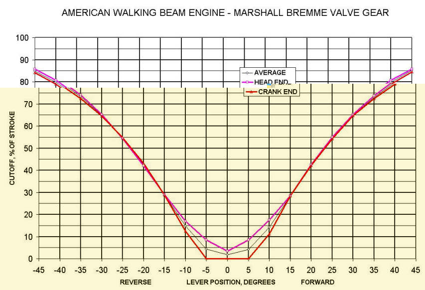

I have also written EXCEL software for simple engine valve gear, in my case Marshall-Bremme, (or Klug in some countries), allowing the user to vary any dimension for every variable. I experimented with this geometry about a billion times (OK, I'm exaggerating) to get my valve gear that is almost perfect with all realistic cutoffs in both forward and reverse,
I have 9 notches forward and nine notches astern, with virtually the same cutoffs ahead or astern, head end of the cylinder as well as the crank end, from 30% cutoff to 85% cutoff. It makes me wonder why more engines do not use this type of valve gear?.

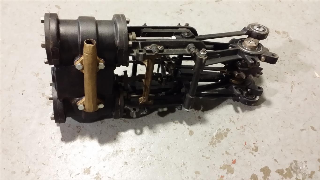

This is contradicting the designs of some very brilliant designers and engineers, like George Whitney who designed this engine around 1896. As you can see in the drawing pic, how much the radius is effected by shortening the suspension arm and how it relates to sideways motion of the die block which should be minimized for wear and why these should be kept as long as possible. It works in your CAD model, but I think it is something you'll regret having an excessive amount of.
No offense, but the 6A is being presented as some sort of metric to make broad generalizations about all steam engines. The 6A is known to be physically small for it's stroke. Which causes excessive loading on the crosshead guides, short coupled valve linkages etc.

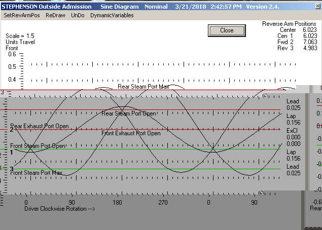

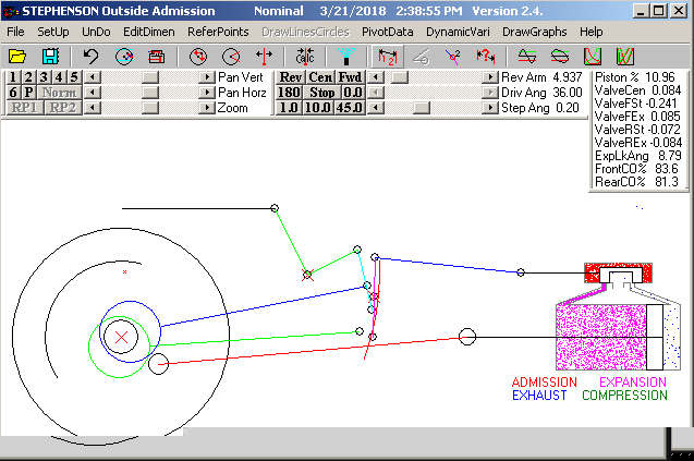

One can look into the Dockstadder freeware (screen shots shown below), which shows an animation of the engine and its valve motion, plus several graphs of valve events to see where shortcomings may become manifest. The user can change any dimension, set the engine speed, the position of the reversing lever, etc.
Far better time spent here than on conventional TV programming, in my view.
