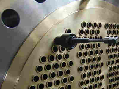

"Tubes are in the equidistant hexagon pattern (still not sure of the proper name for this shape, I'm sure it's in this very thread somewhere...) "
In the Heat Exchanger world, that is called "Equilateral Tube Pitch"
Your tube spacing allows at least 0.65 inches from a tube to the inside of the boiler shell, that is good as it is enough room for the weld of tubesheet to shell without being too close to the tube.
Equilateral pitch tube spacing

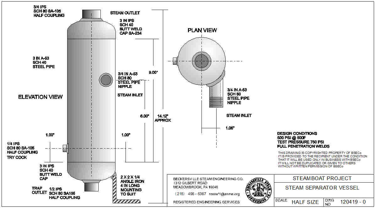

Re: From napkins to fabrication VFT boiler design
Separator
Post by Spanky »
I was actually wondering if there was one that fits inside the boiler. In "steamboats" there is an illustration of a perforated pipe. If I replaced my center tube with this would it work? I don't think much sloshing of the water occurs at the center
Josh
A perforated horizontal pipe, mounted high in the steam space (called a Dry Pipe) is used on many traction engine boilers and similar horizontal shell boilers. I have not seen them on a Stanley type VFT boiler.
