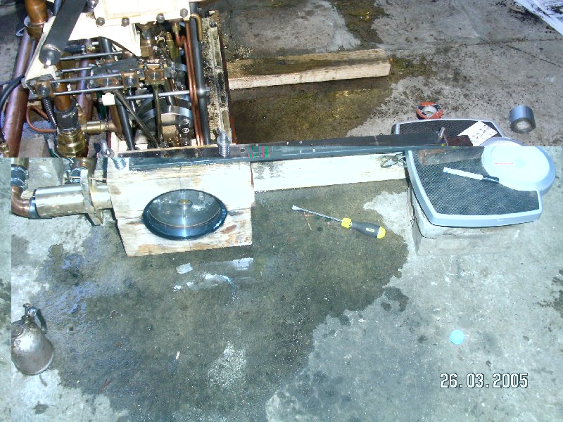

Here is a photo of the brake arrangement:
Steaming 26.04.05 Prony Brake small.jpg (147.98 KiB) Viewed 19772 times
Here's one of the brake showing the inboard condenser:
Brake Setup1.jpg (131.89 KiB) Viewed 19772 times

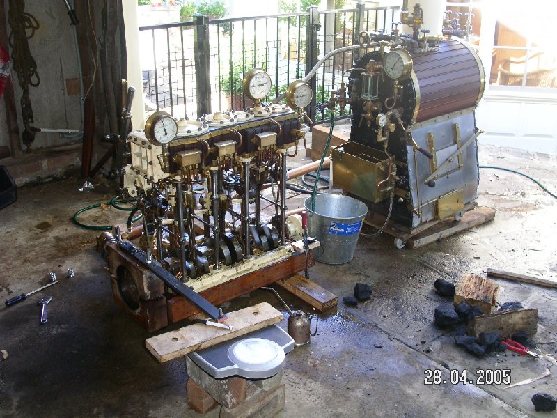

Here's another view:
On each occasion I had some difficulty balancing a big enough fire to keep the pressure up and the need for stopping and starting the engine to tend to the burning brake. I ended up with a smallish fire and extensive use of the blower to avoid the safety blowing and annoying the neighbours. I found that the pressure dropped fairly quickly when the engine was under full load. I reckon another horsepower or so was probably there if I had been able to maintain a roaring fire.
If you can decipher the table you will see that the maximum pressure on the brake was 63 lbs at a radius of 24" giving a brake horsepower of 7.2 @ 300rpm and 185psi.
My original valve calculations gave an estimated horsepower of 7.4 @300rpm so I was very pleased with the outcome on the brake. Those calculations gave an IHP of 11.4 and I used a card factor of 0.66 to estimate the BHP.
The same spreadsheet suggests that, at my maximum revolutions in the boat of 380, the engine is probably producing about 9.5 BHP

Ref the comments by Peter,
I only really did the brake tests to put some load on the engine; I do not think the results are very accurate or in fact very important. What is really wanted is to get the engine in the boat and loaded up while taking a “set of cards” this is the only way to know what’s going on in each cylinder regarding particularly the valve settings and the engine cylinders can be balanced for power, if properly designed it should produce about the same IHP on each cylinder.
I have an engine indicator but this would probably suffer from “cord whip” at 400 RPM. Modern large engines now use computers to do this, measuring the pressure in each cylinder and using a devise to locate the crank position & speed they produce very accurate diagrams and log the various parameters and indicated power.
I expect somewhere out there somebody has the software which could produce a simplified version.
Weigh shaft position: Study of the drawings supplied by Elliott Bay soon showed that something was very wrong here, I suspect the following: - the weigh shaft position was put in an arbitory place mainly to suit the pivot lugs conveniently incorporated with the valve cover castings. Having drawn in the links I suspect they then realized the reversing arms would foul the links and so increased the length of the drag links to compensate, this of course throws the whole geometry out leading to a large amount of “link slip”.
It is often the case that people who should know better do this kind of thing; the weigh shaft position has to be part of the overall link geometry.
What is really puzzling is that a couple of engines have been built with this obvious error. I submitted a diagram in the old forum which shows the correct theoretical position of the weight shaft etc. which I use on all engines with Stephenson gear.
Regarding the reversing arms, EB’s publicity makes much of the independent cut off arrangements, however the angle of the adjustment slot is incorrect and I believe such items are only required on ocean going vessels I have therefore not fitted these.
The reason that my links are opposite to Peter’s is that I have assembled the engine with “open rods” instead of “crossed” I always prefer to use “open rods” this is because these allow the lead to increase when “linking up” instead of decreasing. The engine can therefore be arranged with a fairly small lead in full gear. Also “crossed rods” make the valve travel reduce considerably when linking up causing wire-drawing.
Regarding the aux. pumps these were designed and the castings supplied by Bill Lowe of the U.S.A. and are driven by a reduction gear of about 1:3, the pumps themselves are ok although air pumps should always be vertical single acting to reduce air being trapped in the clearance volumes which maybe a problem with this horizontal pump.
The drive system however was a very poor setup and has taken a lot of re-designing.
I would like to thank everyone who has admired the engine on this forum as it has taken me many hours of re-designing to get it sorted not to mention many hours in my workshop although to be fair I came to the project after the cylinder block had been machined and a few other items started.
Regards Jack
