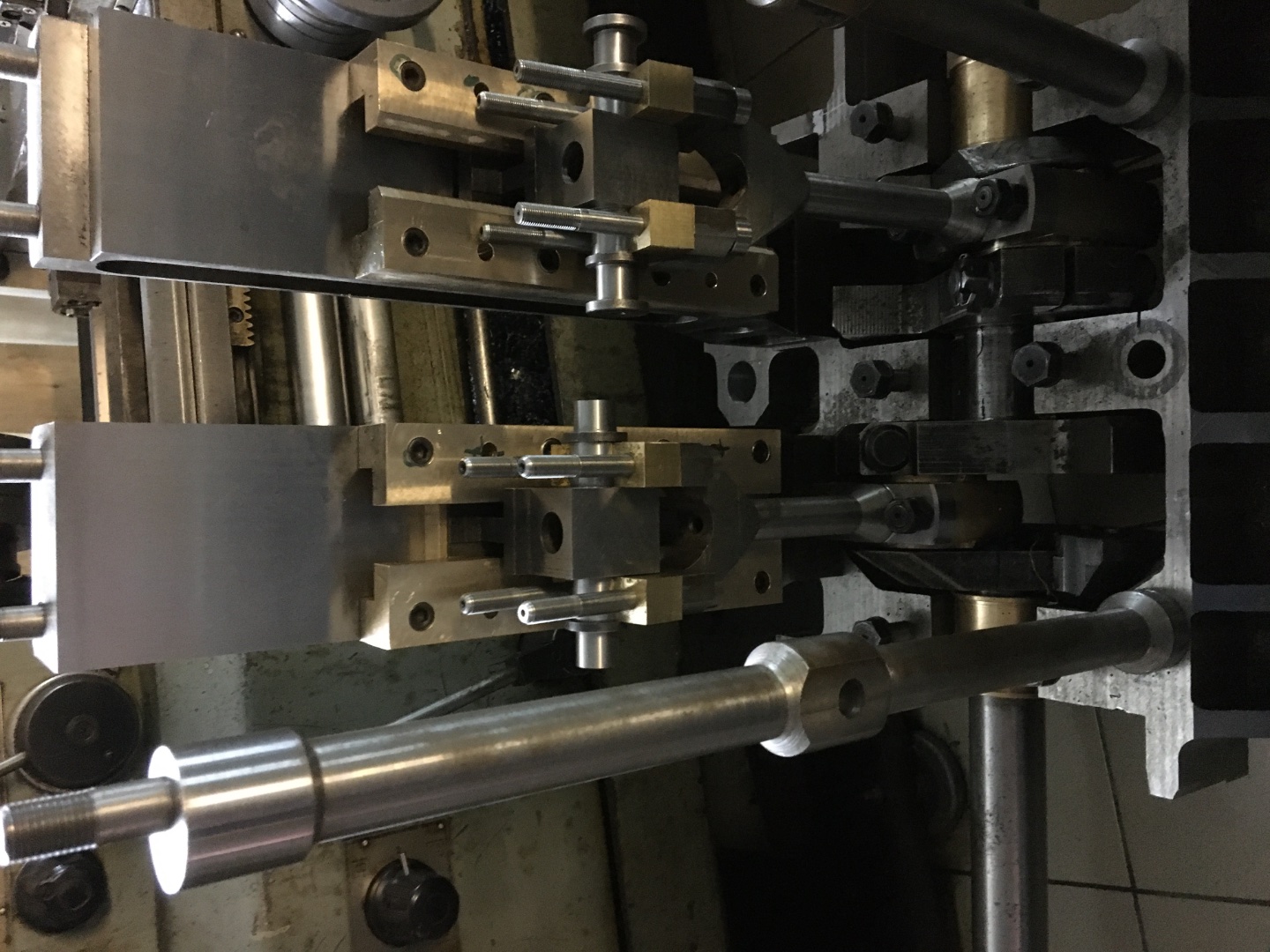

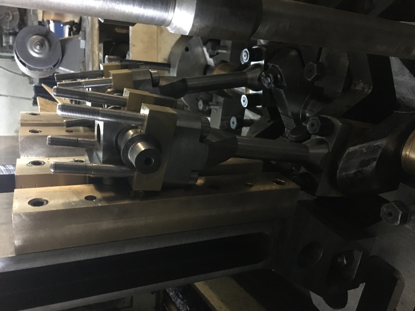

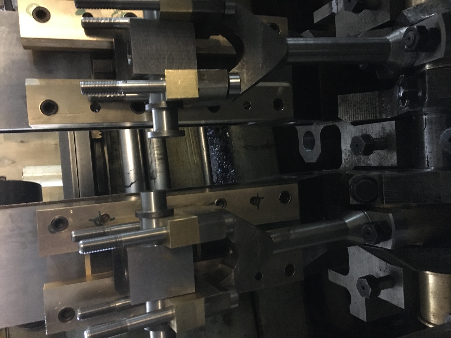

The bronze rails are secured with 10 mm screws. to steel columns that have a hard surface. The crosshead, with its bronze shoe, should slide over the surface of these columns. Crank rotation - left, counterclockwise. Perhaps the forum members will advise me on how to apply olive oil to the columns or to the crosshead shoes. I am aware that lubrication channels can be made on the surface of the columns. What are the best shapes for these channels?

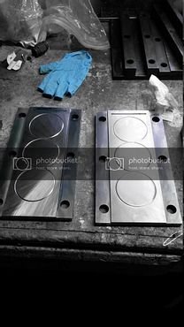

Here are the original guides from our 1909 Doty Compound, and the new guides we made. We just used an indexable milling cutter to cut the groves about 1 mm deep. (Sorry for the photobucket watermark. They're holding my photos hostage.)

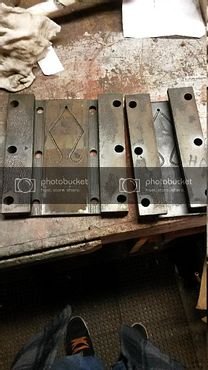

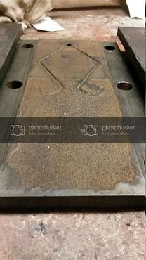

Thanks to TahoeSteam for the advice on the shape of the olive grooves that can be made on the columns. I confess that I have seen a similar design. In one of the books published in Russia on the construction of steam engines, there was information that the olive grooves made on the columns lead to the rapid and severe wear of the bronze shoes on the crossheads. Therefore, I am not yet relieved of doubts about the need to make oil channels on the guide columns. I saw a drawing in one of the books where diamond-shaped oil channels were made on bronze crosshead shoes. The oil was supplied from above through one straight oil channel made exactly in the middle on the guide column. A similar design was used on steam locomotives. Are any of the forum participants familiar with such a design on steam engines of boats?

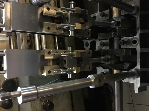

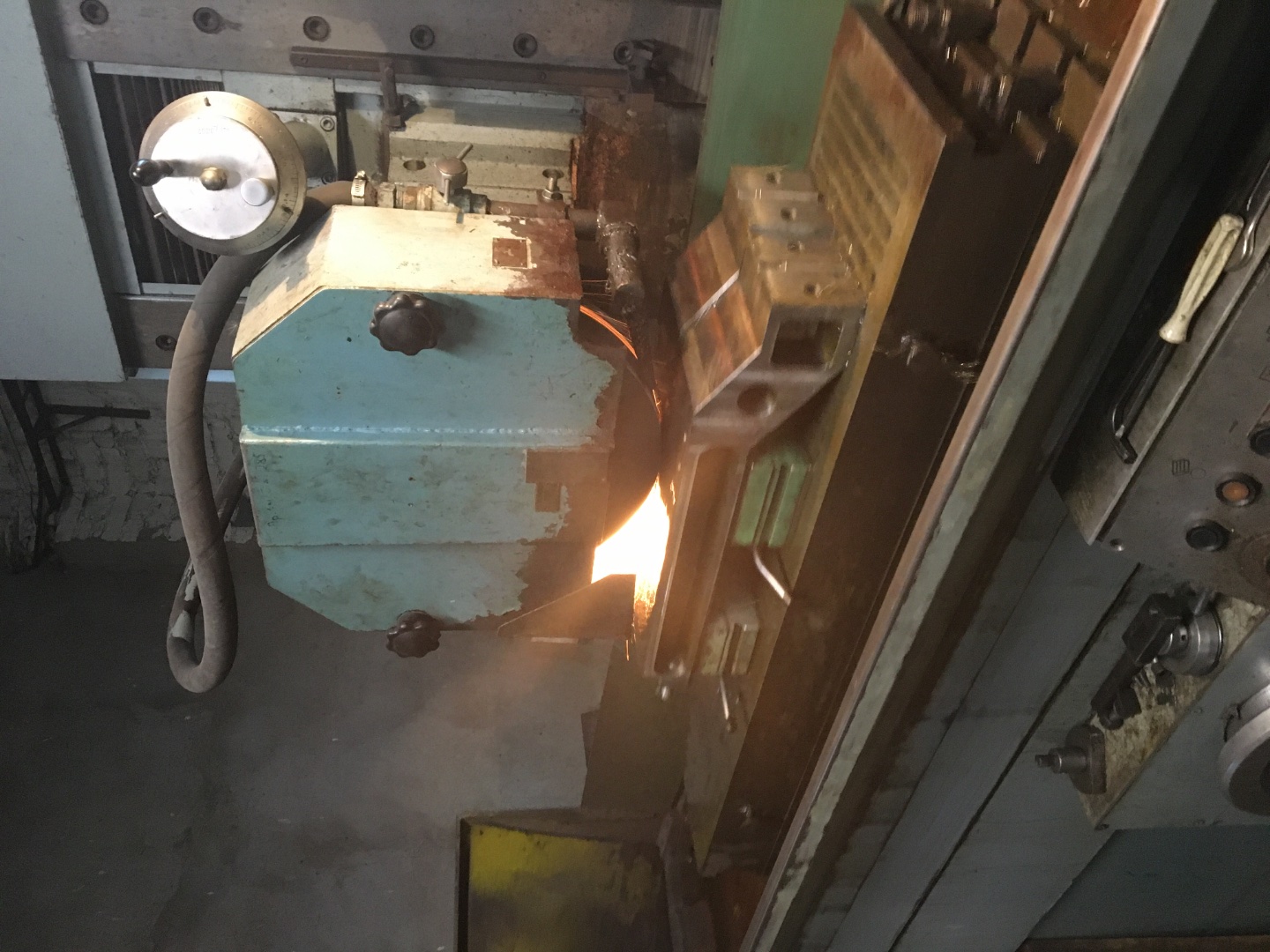

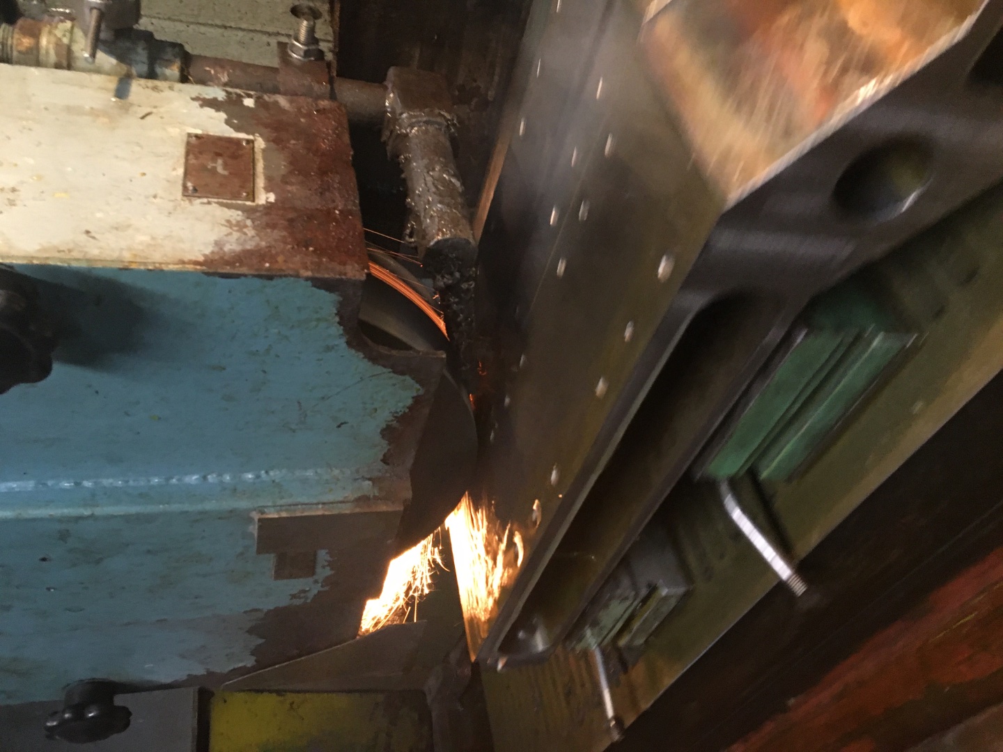

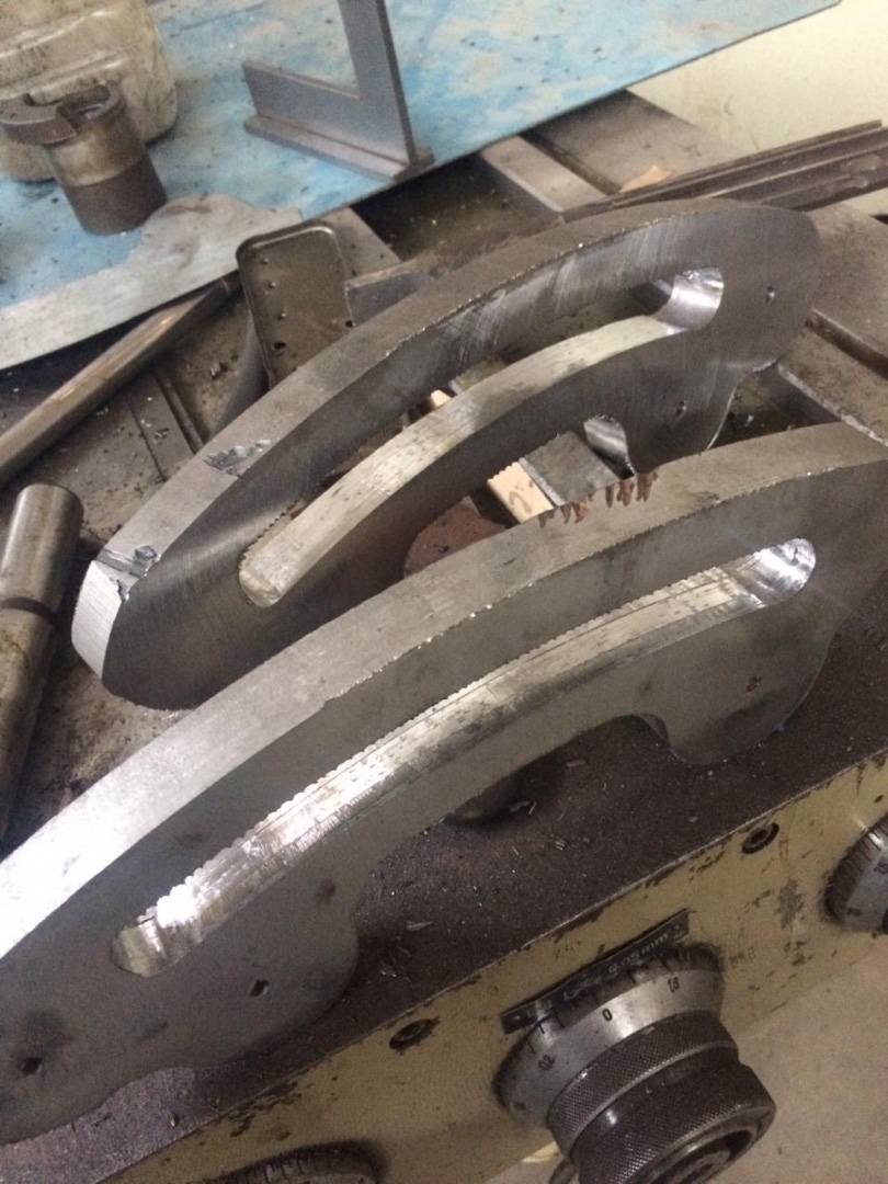

Dear dampfspieler, PeteThePen 1, RNoe, oilking and all steam engine enthusiasts. I thank you for your technical support. Dampfspieler posted a very useful photo for me of meek eccentric rods driving the wings. I hesitated to make these rods short, but now I see that they work great. The slit width of my stage is 24 mm. that is, about 1 inch. I think that this is not enough, it is necessary to increase the width of the Bolle slot 31-32 mm. Are there any recommendations on this issue? I can inform the forum participants that the final installation of the columns was not easy and had to resort to grinding work. I posted a photo of this process. What will be the shape of the oil channels, I have not yet decided. The opinion of one of the forum participants that gaskets are needed under the bronze guide rails, I took as a guide to action. Do the forum participants have information on how quickly the bronze shoe of the crosspiece (crosshead) wears out and how many hours of work will render the crosspiece unusable? PeteThePen 1's warning about photo theft remains unclear to me. Does it make sense to post other photos on the site?

I beg your pardon for my English. I had to write about the width of the stephenson link slot -24mm. I think that this is a small size, 31-32 mm should be made, for the purpose of more reliable and durable operation of this mechanism.
On journal bearings, the oil grooves are cut on the softer metal, the Babbitt metal rather than the steel shaft. I would think the same rule would apply to the crosshead, with a steel surface having no oil grooves, ??
