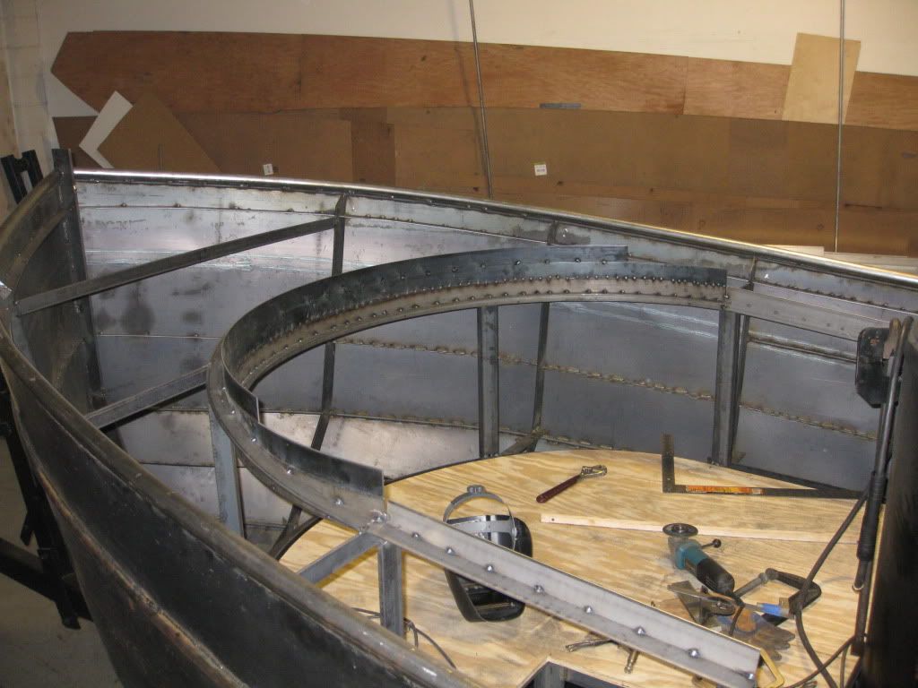

haven't updated in a while. More progress. Just a little more welding to do, and it's ready to sandblast and paint.

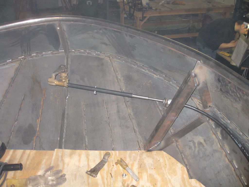

Here shows framing up the pilot house, and the push-pull steering system which is under the floor. It will be controlled via a roller chain from the steering wheel.
Those old Chris Craft parts coming in handy.
This pic shows the stairwell going up in to the pilot house from the engine room:

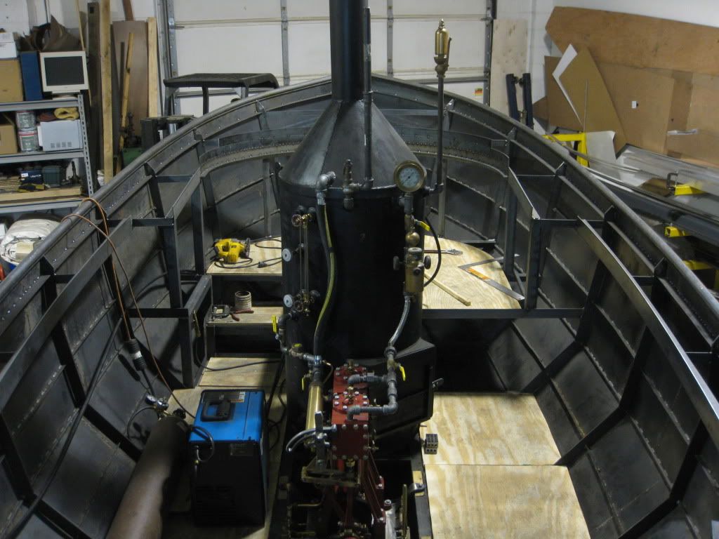

Foredeck detail:
Showing most of the deck and catwalk bracing installed:
