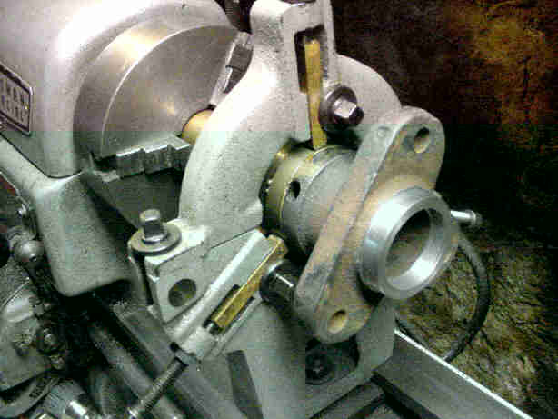

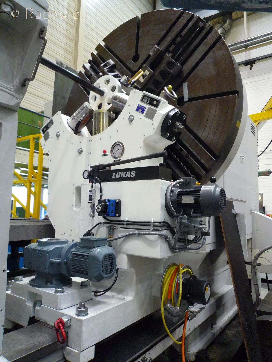

I am working in a 18 people company which is producing steady rests for workpieces from 10 Gramm up to 100 tons. All our steady rests are made from cast iron with piece weights from 100 kg to 2 tons. We don't 'rest' this pieces because the customer expect from us to deliver such a tailor made steady rest after signing the contract within 10 to 14 weeks - including full design, pattern making, pouring and machining
-> but that's why they don't order in China...
This is me test running a 14 m long and 66 tons heavy workpiece at our new delivered steady rests at the customers work shop. Center height = 1250 mm. One steady rest is 2.5 tons heavy - made from 1 cast iron part.
This is also a "normal" cast iron workpiece size for us - 1600 mm center height good for holding 30 tons turbine shafts
One advantage of the cast iron pieces against a welded construction is that you don't have to anneal it for stress release - this saves time and money! Also meanwhile we know in which steps we have to machine our workpieces to get a high quality steady rest from it.
I think that's what I have to learn with my cylinder block too. So at first I will machine away only about half of the allowance at all "big" surfaces to get out all possible internal stress from pouring.

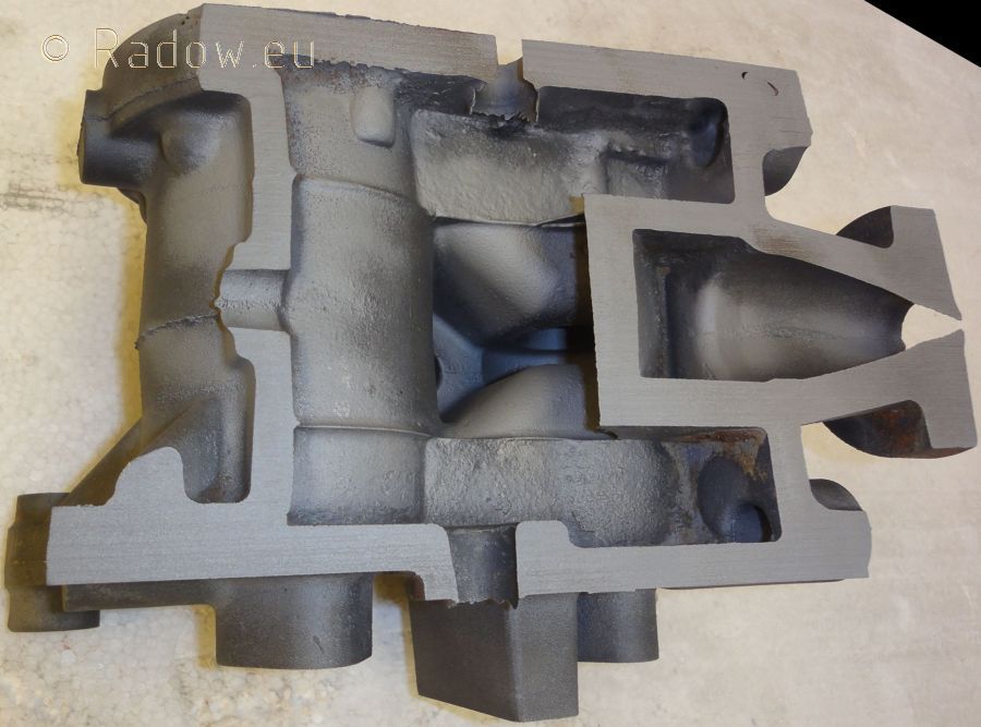

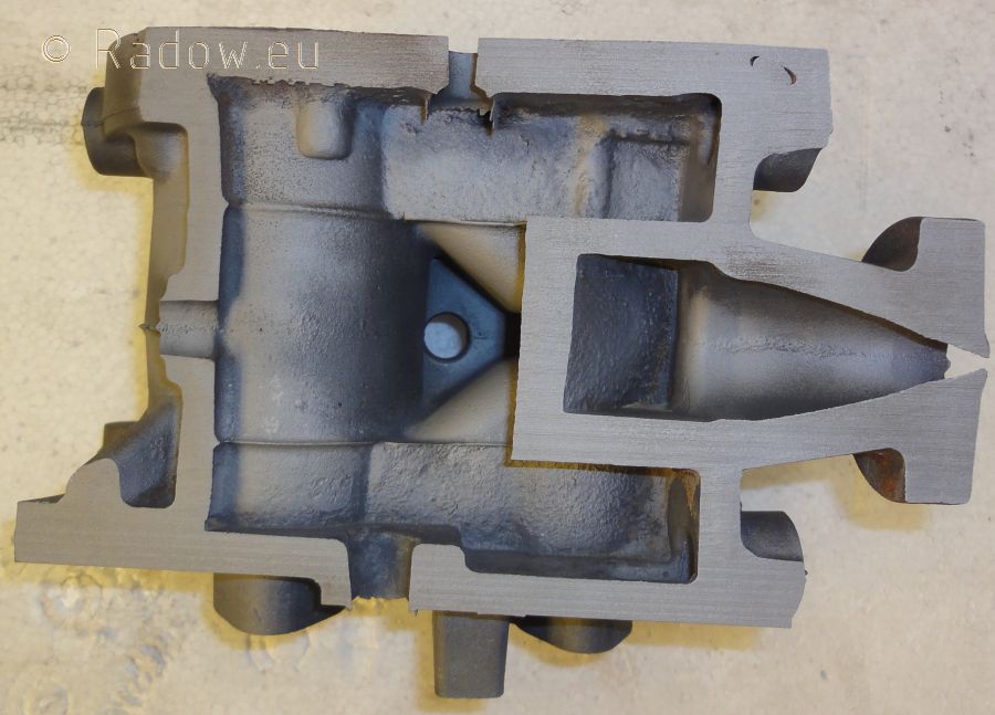

First pouring
Hello Boys (any girls here?),
now I can show you a "live cross section" view of my cylinder. The band saw cut goes right through the receiver which is located between the HP and LP side.
It is the cylinder with the "boiling core" defect because of a to high pouring temperature respectively because of a not so good degazing of the cores.
This pictures gives you the view to the LP side. Cylinder at the right. Valve at the left. The big chamber at the right is the integrated receiver. The flange at the left is the exhaust port. In the middle this is connected to the the exhaust room of the LP piston valve.
At the top you can easily identify the defect which connects the receiver with the exhaust and the LP top steam passage. The foundry men told me that it is not an unusual procedure to have some misfortune before you will know how to vent a complex part and what's the best temperature for pouring.
This is the good side of the cylinder - you could make a single from it
HP Cylinder at the left, valve cylinder at the right. Big flange is the other half of the exhaust. The internal smal round part at the top left is a boss for the top cover screws. Hope to find them when drilling the holes...
Same side of the cut - just to give you an other perspective. Here you can look into the exhaust room of the HP piston valve.

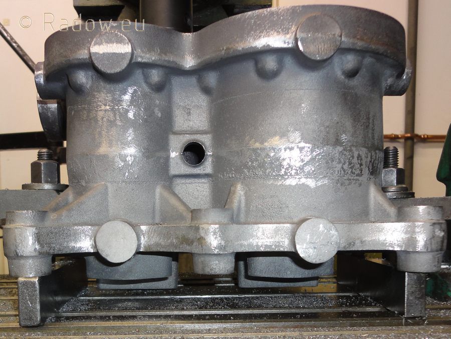

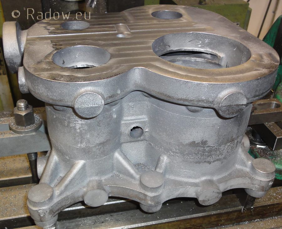

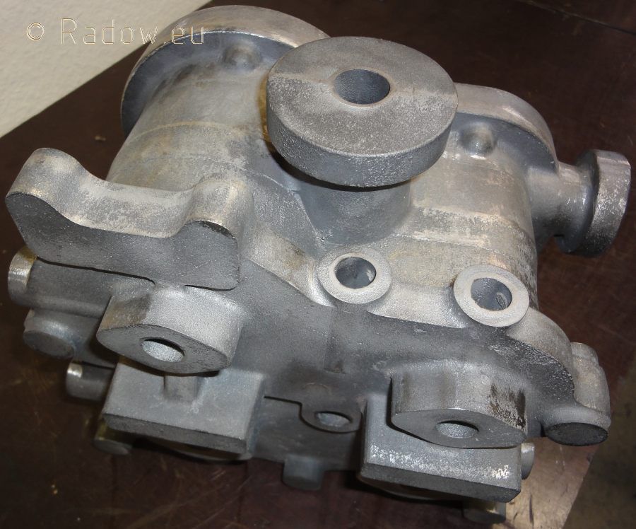

Here is one of the good ones!
Fresh out of the foundry. I told them "No cutoff grinding and no sanding please":
Some 30 minutes later ready for painting
The cores for the two drains at the right are 14 mm (0.55 inch) in diameter. The smallest core in this part builds the valverod guidance with a diameter of 12 mm (0.47 inch)
I placed it direct at the sand plasted column support - no additional preparation.
Before this piture was taken I milled away only about 0,7 mm (0.03 inch). The still unmachined surfaces at the left and the right are about 0,5 mm (0.02 inch) deeper. Please remember this part came out of a 4 parted mold - congratulation to the foundry!
After that I turned the cylinder over and placed it with the fresh machined surface on the plane table. With the Faro Gage I found deviations from about 0,2 mm (0.008 inch) compared to the plane table at the non machined but sandblasted surface. No bending or other imperfections.
