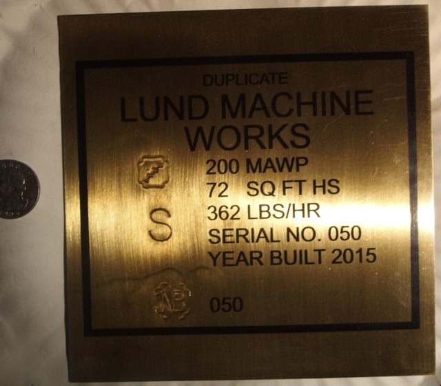

Boiler Plate
Boiler Plate
I had a plate to go outside of the lagging laser etched and sent it back to my boiler make Lund Machine Works(Jeff Lund) to stamp. The 'Duplicate" is required so someone doesn't take it and put it on any old kettle. :) The same is stamped into the boiler shell.
ASME clover Stamp,, S - Steam Stamp, National Board stamp.
I put some(too much) clear enamel on it, it will be on the outside of the mahogany lagging - I hope the enamel doesn't crackle - I'll have to see.
