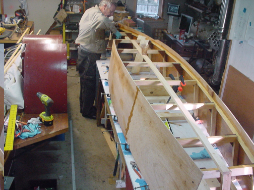

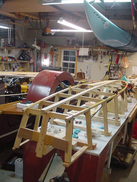

- Frames on Building Table, Epoxied the Chines in place Today, Sides go on Tomorrow
- FramesCanoe.jpg (104.28 KiB) Viewed 21660 times

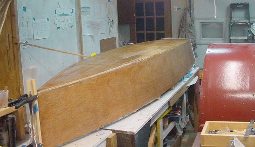

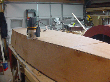

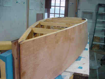

A little more progress on the small hull. Thinking of using sidewheel paddles, with bycycle type pedal power, then I can put in a small steam plant some day, if I live long enough.
- rounding chine.jpg (94.48 KiB) Viewed 21617 times
- attach sides.jpg (181.51 KiB) Viewed 21617 times

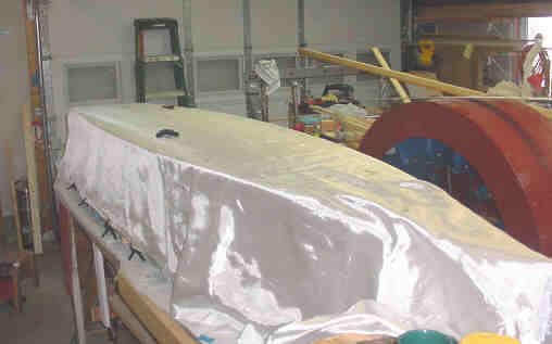

Weekend Work, got the 10 oz cloth onto the hull, and epoxied in place. Nex steps, some sanding, fill the weave, more sanding.
- epoxy on fiberglass.jpg (143.45 KiB) Viewed 21617 times
- fiberglass cloth.jpg (12.41 KiB) Viewed 21617 times
- ready for bottom.jpg (9.1 KiB) Viewed 21617 times

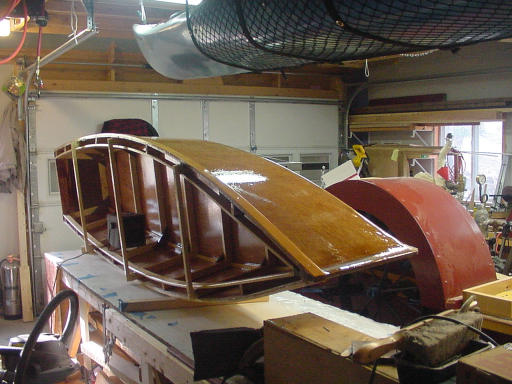

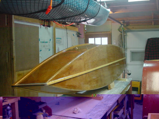

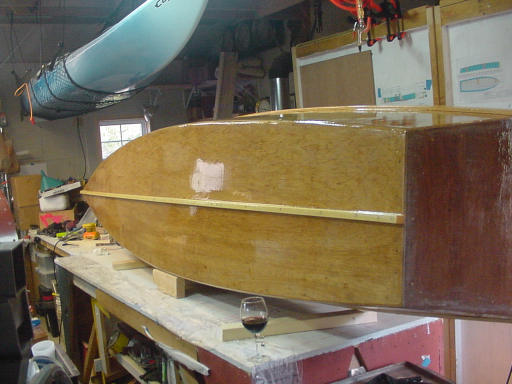

The little boat is just about finished now, put the final coat of epoxy on the hull exterior today. I plan to use double kayak paddles, but my son is welding together a foot pedal powered set of sidewheel paddles. This mechanism will drop into the small boat and be clamped to the frames, and it will look very similar to the wheels of the bigger steamer.
- CANOEINTERIOR.jpg (47.71 KiB) Viewed 21516 times
- CANOESTERN.jpg (38.49 KiB) Viewed 21516 times
- CANOE.jpg (38.92 KiB) Viewed 21516 times
