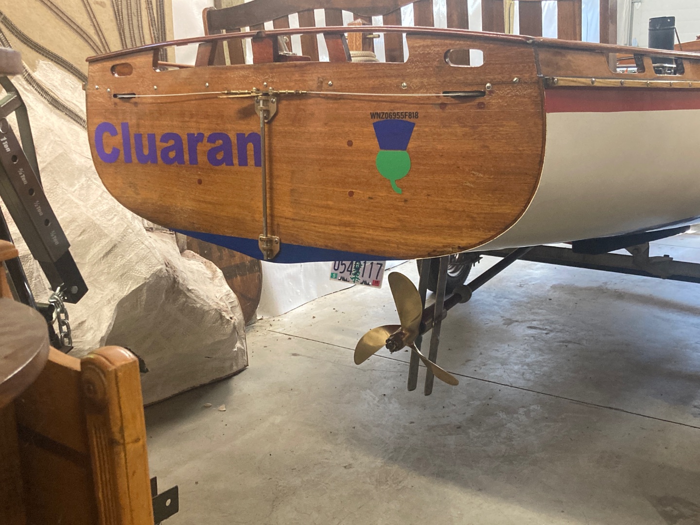

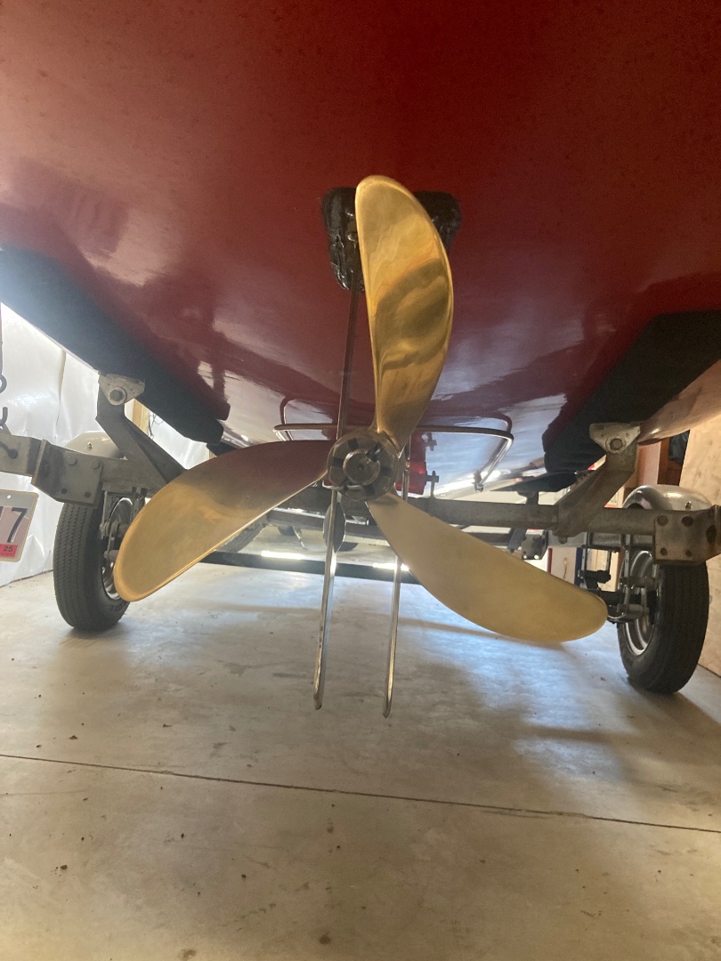

Finally (!!!) today I finished installing the new prop on Cluaran. This project only took 1 year from beginning searching for a classic prop casting,
then finishing it, and finally fitting it. Had to R&R the shaft threads and make a new key. It all went disturbingly well.
Next are more performance tests. Date unknown. Here's hoping...

Posts: 577
Re: Steam Thistle Cluaran
Well done Russ
That looks fabulous and from all you have reported it sounds to have been installed with a high degree of precision. I hope that you get a chance to try it out soon.
