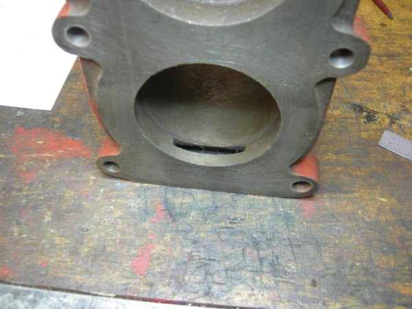

Unfortunately unlike the Hybrid there is only the block; nothing else at all, not a stitch! It has though, been basically machined, the top and bottom faces, valve port faces and the bores, so that at least is some help.
There are one or two things I'm not totally happy with, like the positioning of the ports, they are a bit far into the bores for my preference and seem to me to be wasting bore length.
Ports (1) (600 x 450).jpg (52.6 KiB) Viewed 87097 times
The block is four inches tall but the positioning of the ports leaves only about two and a half inches available, assuming a piston of around an inch thick. I'm sure I can increase that fairly easily.

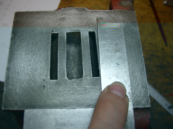

The other thing is the cast in ports on the end faces, whilst easily enough corrected, they leave a little bit to be desired.

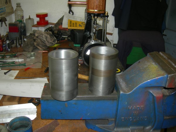

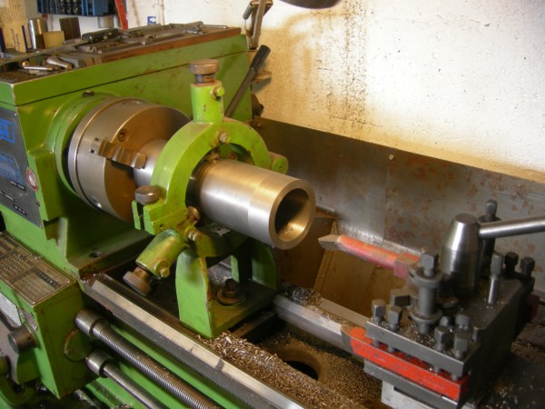

A long 'boring' job, and that's only one. Now out to 2.25" (finish size 2.5"), and then ditto repeato from the other end. The outside dia. can be reduced some, but how much, will be decided when I've bored the block out. While waiting for the cut to finish I've checked the block and found that the bottom face is slightly warped so that will need a light skim which I will probably leave till the liners are in and need trimming off, meaning they will be fitted from the bottom. No biggy!!!
Re: And Now for the Twin
Having bored both ends to the middle, I tried parting the liners, but a lack of rigidity, even with the fixed steady meant recourse to the saw. No problem, as there was plenty of extra length for re-trueing.

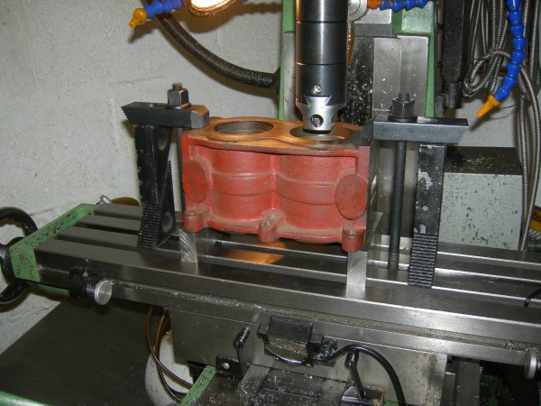

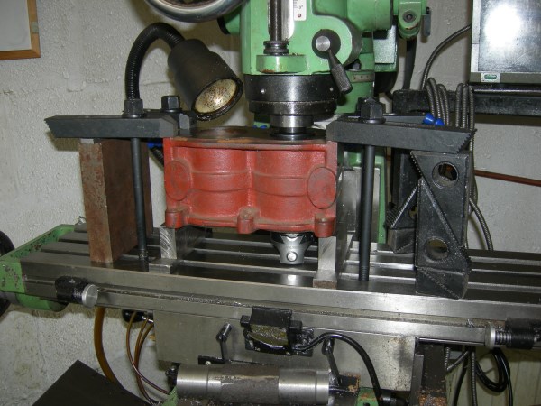

The first setup for boring proved a touch too shallow to allow adjustment of the boring head from below,
Block Boring Settup (1) (600 x 450).jpg (76.04 KiB) Viewed 91926 times

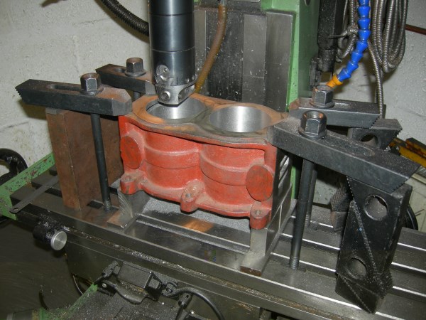

so setup with setup two I decided on belt and braces,
Block Boring Settup (3) (600 x 450).jpg (76.94 KiB) Viewed 91926 times
four clamps. Two would probably have been adequate but why take a risk with a one-off casting? Now ready for the first 'right upper-cut'!

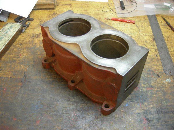

After a lot of handle turning (I've no power feed to the miller knee), the second bore is completed. The difference between both bores is less than 0.0005". Good enough for me!

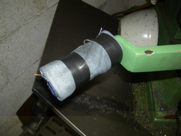

One problem was because the cut was slow and the 40ish turns of the handle for each cut, cramp set in in both hands, so a slight mod was required for the 'knee' handle.
