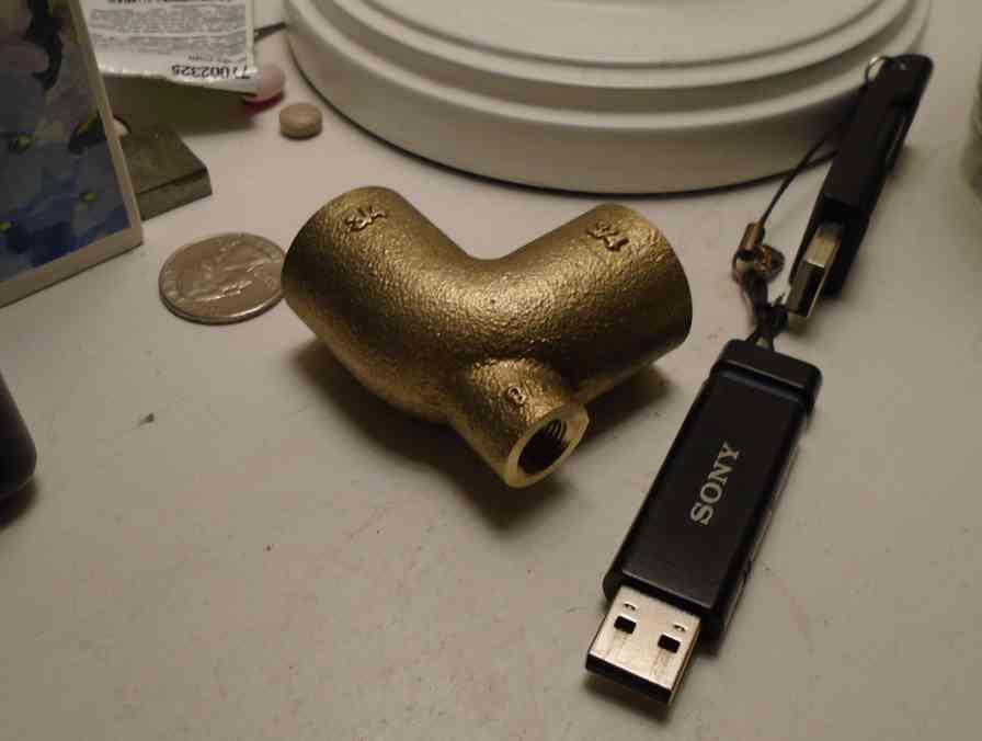

Also ran across a fitting that is perfect for making a steam jet eductor. This brass fitting has 3/4 inch copper sweat connections, with a 1/8 inch NPT threaded connection for the steam jet. I can spin some copper discharge tube into a recovery cone, and should get a very robust bilge pump. Will need to experiment with this setup. I made a similar pump with 1/2 inch copper fittings, it works OK but is a little small for rapid bilge pumpout.

- Brass Fitting for Steam Eductor
- vent el.jpg (25.34 KiB) Viewed 7096 times

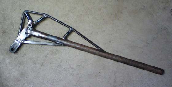

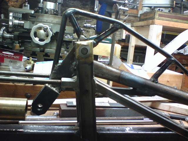

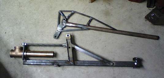

Finally completed welded pump frame and pumping lever. 1-1/16 bore x 4 inch stroke on Bronze pipe for working cylinder. Made everything from light weight steel tubing, so trusswork is used to avoid high stresses. This new hand pump will weigh about half as much as the previous one, and is only 2 inches wide.
Next to make the pump piston & Connecting Rod

- Feed Pump Main Fabricated Parts
- PMP-WELDMENTS.jpg (17.08 KiB) Viewed 7038 times
- Looks somewhat like a Horse Head?
- PMP-LEVER.jpg (17.11 KiB) Viewed 7038 times
- Close-up of Operating Mechanism
- PMP-MECH.jpg (52.58 KiB) Viewed 7038 times

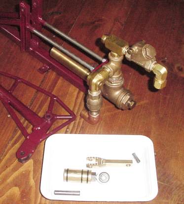

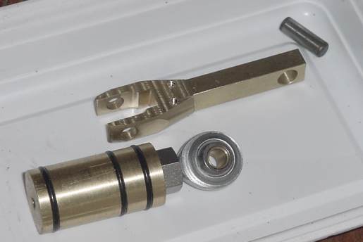

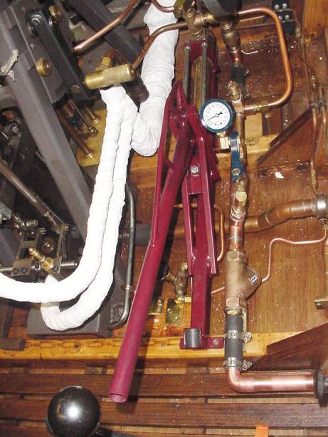

Finally got the new manual feed pump into the boat.
The short connecting rod is made from three brass pieces, silver soldered together. The drilled shallow "wells" in the connecting rod are each filled with a short piece of solder, and when the solder dissapears on heating, a very strong joint is made.
Using a Heim Joint removes many alignment problems inherent when machinery is fabricated by welding. Weld distortions make close fit-up of parts difficult, unless the ball type joints are used.
Getting the pump, suction piping & strainer(for this hand pump, plus the engine driven pump), discharge piping, recirculation/relief lines in place is tricky with a narrow beam boat, fortunately I have the wheels and paddleboxes off, otherwise I would have to hire a teenage contortionist to get things in place.

- pump parts.jpg (22.03 KiB) Viewed 6929 times
- pmp piston.jpg (13.92 KiB) Viewed 6929 times
- pump inst.jpg (49.36 KiB) Viewed 6929 times
