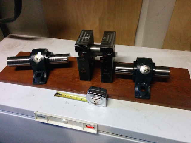

The 2" type E pillow blocks that will be the engine main bearings (and handle the propeller thrust load) arrived this week, along with 26" of 2" 4142 chrome-moly, heat treated, ground and polished. I machined the crankpin from the latter, and made the two ends of the crankshaft; they just needed facing and center-drilling. There's a bit of video in the album showing the 2" shaft in a steady rest. Next it was time to separate the two crank cheeks; a 3/16 end mill worked to machine out the tack welds at either end. I then used the bandsaw to cut the outer web on the crankcheeks so the pinch bolts could work.
The hardened chrome moly shafting cut readily w/ a high-speed blade in my venerable 4x6 bandsaw at a slow speed. I used carbide tools and it machined ok; it is tough. It seems to machine better if I push the feed a bit ore than feels comfortable.
I tested the effect of the pinch bolts; at 100 ft-lbs on each 5/8" Allen head the two crank checks & crankpin are one piece
Next, I need to machine the spacers that center the bearing between the crank cheeks on the crankpin, and have Barbie (who has access to a Maker Space) sandblast the crankshaft cheeks. Then it's time to heat the cheeks to 300F and freeze the shafts, which should give me plenty of slip room to assemble the shafts and cheeks; there's only a bit over .001 interference at room temperature. I'll add 1/2"-NF dutch keys (2 per end) lock-tited in to hold things in place. My backup plan in case this won't hold is to add another pinch bolt between the two shaftt and cut a slit between the two bolt holes, but I doubt I'll need this.

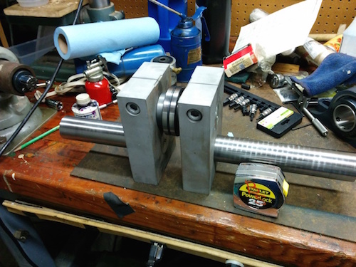

The checks have been sand blasted (thanks Barbie!), and tonight I heated them to 300F and cooled the shafts to near 0F in the chest freezer, and assembled them. It actually takes a minute for the parts to 'grab' since they had about 3+ thou clearance; once they start, of course, it goes very quickly as the contact force and thus the heat transfer increases.
Next it's time to drill and tap for the Dutch keys, and assemble and check between centers on the lathe how close I got things. I may check first to see if the keys affect anything.
I may pick up some metal this week so I can start fabricating the base... a single cylinder engine doesn't take a lot, but the bearing carriers are taking a lot of force (2600 lbs each) so some section is needed between the engine columns and the bearings.
Since the boat design has a box keel, the crank is actually hung under the engine base. I will run copper tubing to the bearings for greasing; this would be hard to pull off w/ a bronze bearing and oil cups
. A low crank keeps the prop shaft straight, and lets us keep the cabin sole low and free of 'lumps and bumps'. This means I also need to make a platform on casters for the engine to sit on during assembly, since the flywheel and crank are actually below the engine bearers.

I torqued up the crank pinch bolts to 100 ft-lbs, and chucked on end in the lathe chuck and the other end on the center. It ran about .007 out of true; an few 'adjustments' w/ a heavy brass hammer and my dial indicator says .0005 - close enough. This weekend I'll try and key the main shafts so they'll stay put when there is 5000 lbs pushing and pulling on the connecting rod.
It's interesting; the peak forces can be quite high w/ uniflows, but the large expansion ratios mean the BMEP is actually quite reasonable.
