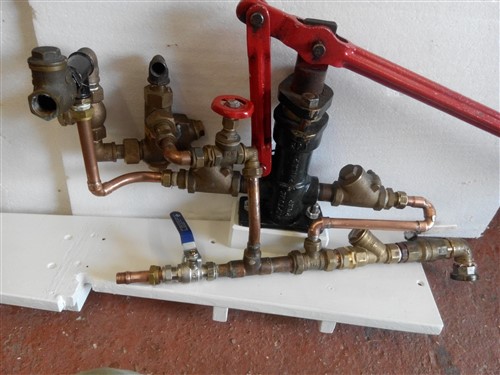

Lake feed as seen from the site of the boiler.
Lake feed system (500 x 375).jpg (50.78 KiB) Viewed 16967 times

Pete,
I wouldn't bother with the reserve tank in FA as there isn't enough room to hold enough water to make it worth the effort- given where the locker location is I doubt even filling the reserve tank would be an easy exercise; in an ideal world a tank holding enough water to get you a couple of miles to a jetty in an emergency would be great- that size tank would take FA down by the bows by way too much. Given the hull is just about on it's limit with COG when carrying the cabin and passengers I would do all you can to keep weight amidships and not add anything you really don't need.
