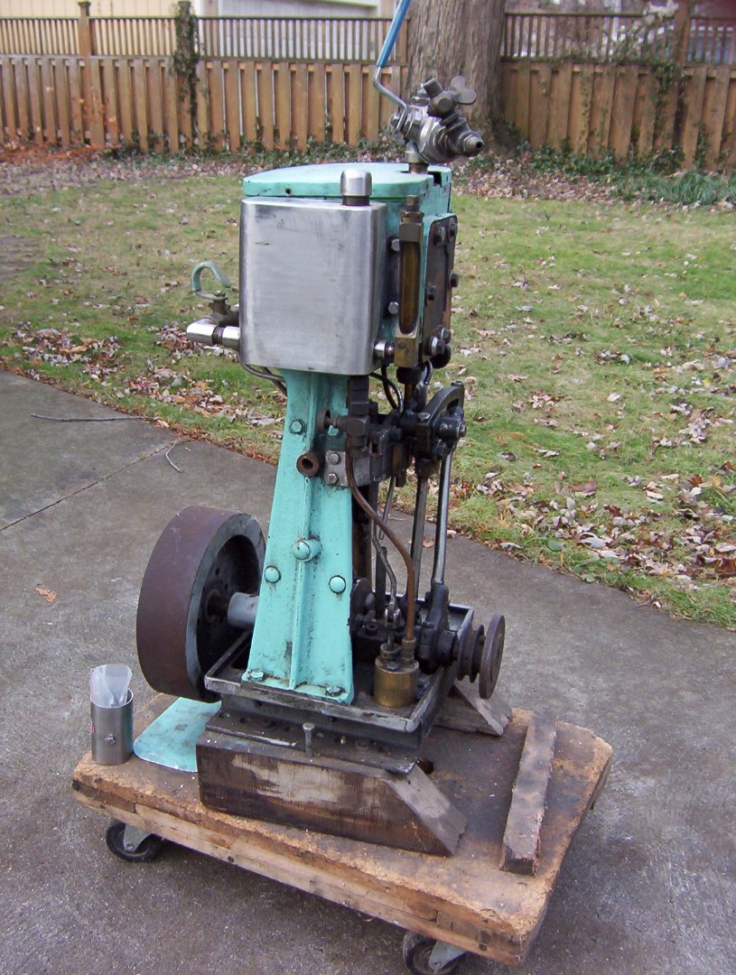

Curious if anyone has risked re-using their oil from their engines? I know oil is cheap compared to bearings, and most don't use very much in a run, or even a season.
Now that we're using nearly a quart a run or more (we run 4-8hrs at a time regularly) several times a month, I'm wondering about having a recovery system of sorts. Strainer, water separator, then automotive filter?
Thoughts?
It appears to me that this fine little engine is equipped with a sump pump (lower right) that discharges into the stainless oil reservoir up top.

Unless there is some bearing failure in progress, the only thing getting mixed into your used oil should be water. And I can't think of any reason that some water mixed in with the oil would be a problem. If you really want to reuse your oil then just letting it settle ought to do the trick. And maybe throw a magnet in your collection pan.

A quart of oil in 4-8 hours seems like an awful lot. I probably use about 2/3 of a cup, if that in a day's running. To each his own!

I was thinking contaminants like dust, dirt, discarded chewing gum, those Legos your kids leave out and you find with your bare feet at 2am on the way to the bathroom, etc...
We have gallons of used sump oil laying about that is either going to be burnt, brought to a recycling center, or used in an fertilizer experiment
Kelly, the engine is the one in our 40' boat "Persistance". We regularly run 25 to 50 miles in a day. We've put a few miles on her since we launched her in 2017;
