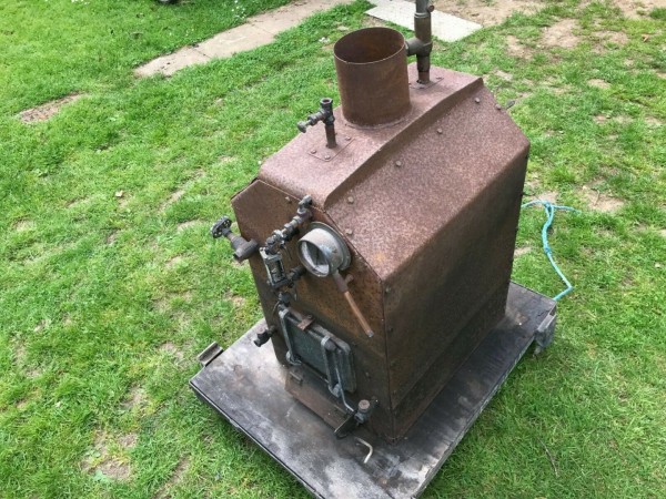

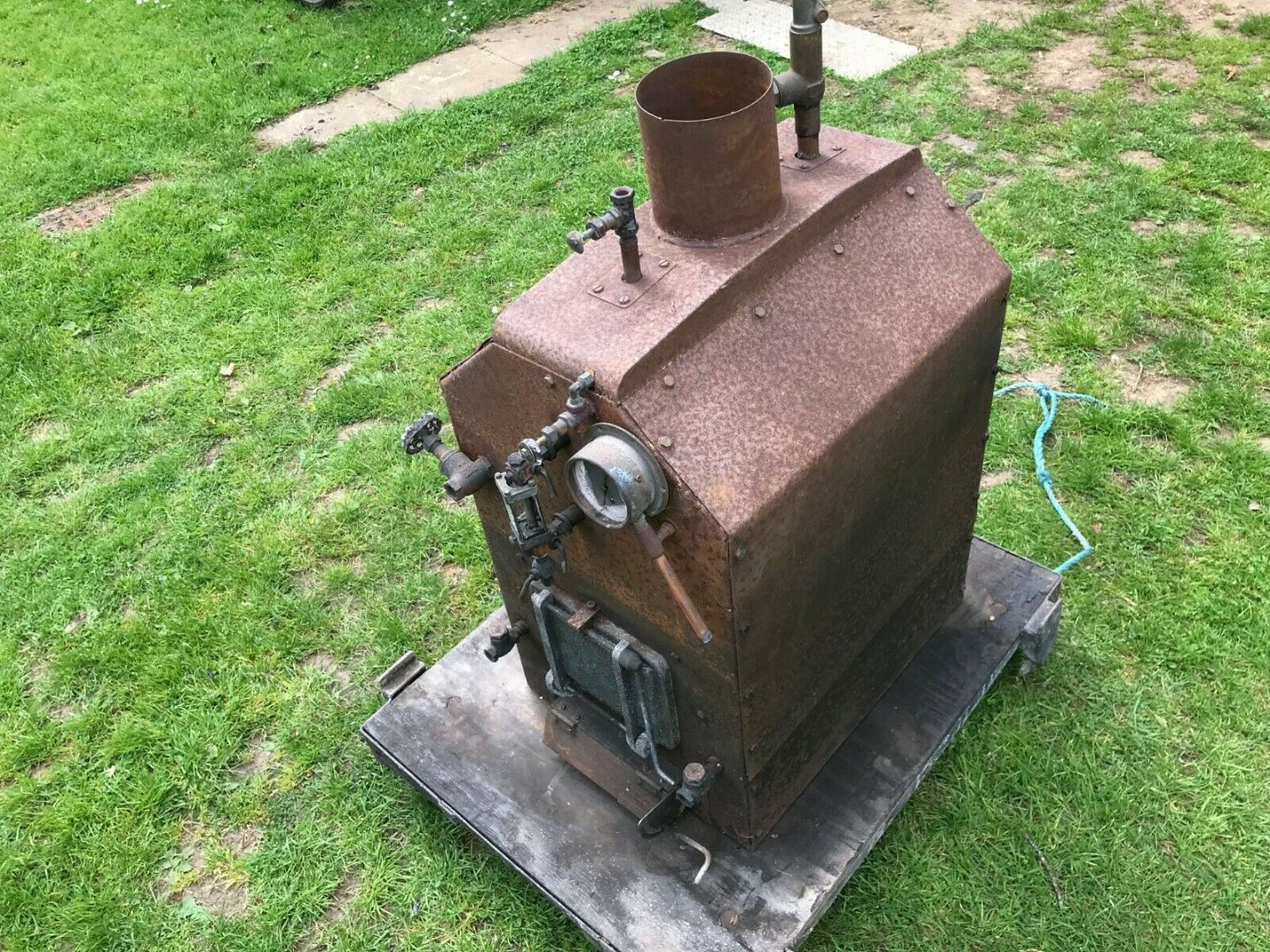

Ok all you wise and wonderful people here's the first of many enquiries.
as the title suggests I have a boiler made by Anthony Bever it has been in a building fire and was hot enough to shatter the shield glass on the sight gauge as you may be able to see in the picture. my intention is to dismantle it and clean de rust and paint/stove black the outside and generally give it a good once over.
is there anything I should be doing in order to finally get it tested and certified ? ( I do have the original test and inspection paperwork from 1993 )
many thanks in advance
Ivan
Ivan

Tricky topic....
Are you in the UK? I know nothing of the legal/regulatory requirements there other than they are much more stringent than we have in the USA. Consult local experts as to inspection/testing required.
The pressure vessel portion of the boiler is very unlikely to have been adversely affected by the fire, whether copper or steel. The same insulation that keeps internal heat will have kept the external heat out
. In addition, what looks like aluminum portions of the firebox door hinges, etc. seem to be fine, so temperatures were not extreme.
I believe these watertube boilers are have three steel drums welded together w/ bent copper tubes silver soldered into steel nipples welded into the drums, very much like the basic construction I used for Otter's boiler 25+ years ago. After disassembly and cleaning it will very likely pass a hydro test of the pressure vessel at 150% of the maximum working pressure. It does look to be well weathered so do look for external corrosion issues on steel parts.
I'd wear a respirator during disassembly if soft fiber insulation is used; the silica fiber insulation likely used is not friendly to the lungs.
You'll need to replace the safety valve (likely cheaper than having it rebuilt). The valves may be ok depending on the heat levels reached and the valve seat materials. Disassemble and inspect; check check valve springs in case they were annealed.
Good luck!

I had a Anthony Beaver boiler in my first steam launch 'Silver Rose' They are welded steal water tube which steam very well however do rust particularly if the insulation material has been allowed to remain water logged during storage - check where the steam generating tubes meet the mud drums. Join the SBA and talk to them.

Thanks for your advice Nigel although it looks rusty that's mainly due to being in the fire aside from that it's been dry stored so I'm hopeful it wont be to bad once I get inside.
