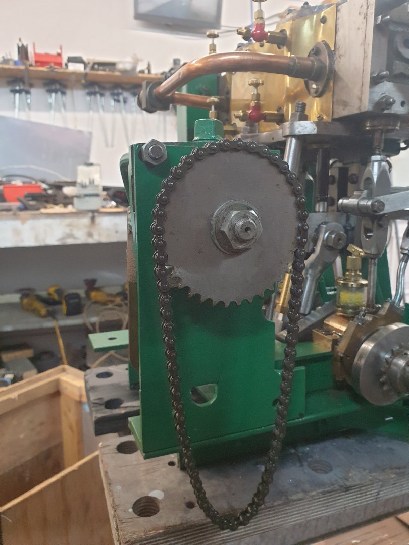

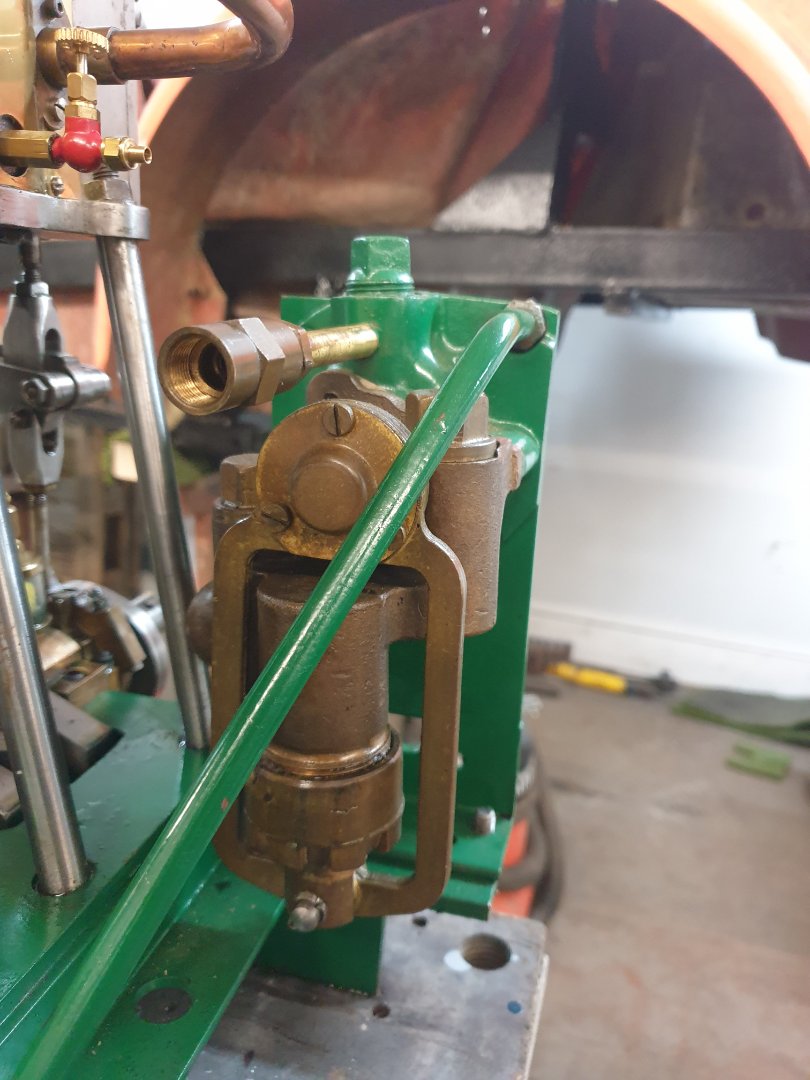

As a complete newbie can you knowledgeable people help me with the following
- It's a pump but what for?

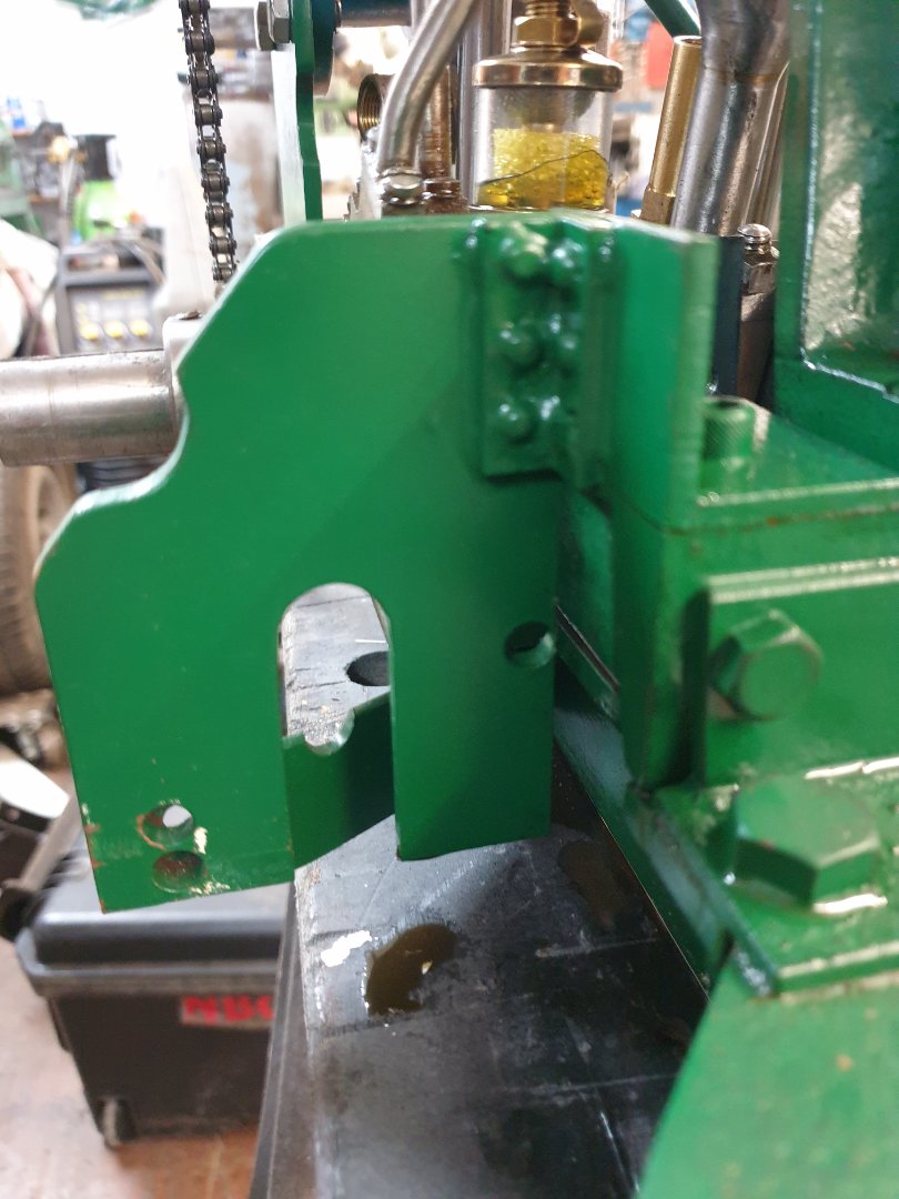

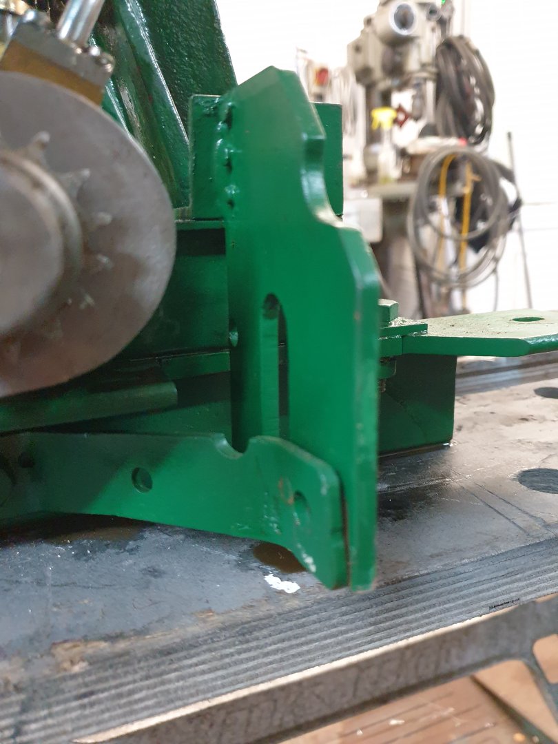

And also
there's obviously something missing I'm guessing it's another pump but again what for?

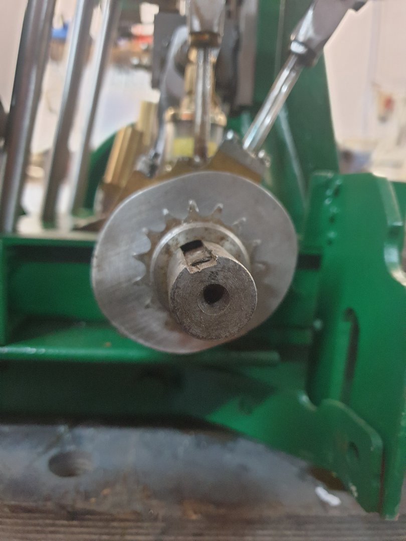

The first pump is the boiler feed water pump. The roller chain needs to be mounted on the sprocket on the crankshaft. The brass pipe is the delivery to the boiler.

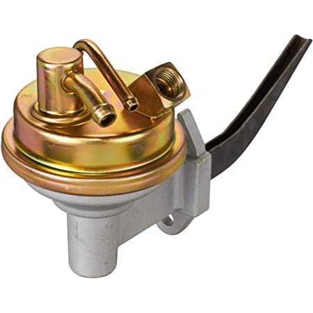

As far as the cam on the crankshaft and the adjoining bracket, I'm going to speculate that a cam operated gas engine fuel pump was mounted there to act as an air pump. The late Issac Harter advocated that system in Live Steam magazine back in the 1970's.

thanks for the reply I did think it might be the BFP but wasn't sure I thought it might be air or vacuum pump as it has a rather large piston.
I did workout the chain drive bit
(it was connected I took it off as I didn't want to run it dry)
and as for the cam I did think another pump but wasn't sure what for but the lift pump idea is a good shout, could it be for condenser I wonder.

The feed pump is large diameter because it is geared down, and has a fairly short stroke.
An air pump's only employment is to evacuate a condenser. Perhaps the engine's last employment was on a boat without a condenser, hence the absence of the pump.
