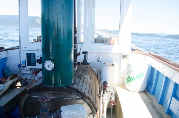

Back when Rainbow was in the water, one of the more difficult/risky tasks while steaming single handed was going forward, around the windshield and fishing a five gallon ( 40 lbs) water container out of the forward hatch and bringing back to the cockpit and pouring it into the hotwell. Here you can see one of the water containers, and the previous hotwell:
In order to make things less dubious, I'm going to add a poly water tank up forward in the hold so I can add water to the boiler/hotwell using a pump w/o the risk of falling overboard. Now, I've estimated the water circulation rate at something around 12-15 gallons/hour, since Rainbow makes about 4.5-5.5 hp and is a compound. Some percentage of that is lost, of course. How much is dependent on the condition of the packing on the valves and pumps; Rainbow's valve guides and thus packing were completely worn out, so I don't have any good data there. I'm assuming the captain can restrain himself w/ the steam whistle and siren, of course. I'm curious if anyone has any anecdotal evidence as to what a reasonable figure of water consumption due to leakages might be?
For really long trips (several days), I can carry more water in containers as before, but I don't want to deal with that while steaming or just being out for the weekend. I'm thinking something on the order of 20 gallons or so, which should also provide adequate amounts for personal consumption as well. Any thoughts or comments?

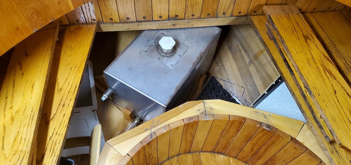

Vividus came with a stainless steel 11 gallon tank which I still use, though it has been moved as far aft as possible to counteract the boiler which is a little too far forward.
She has a compound, 2-5/8" & 4-15/16" x 3-1/2", and normally needs one or two gallons of makeup per day of steaming.
