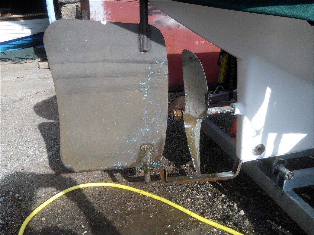

Dear Steamboating Friends
I have become involved in a discussion about 'weed free' propellers for steam launches. I am not sure if weed clogging is an issue for folk in other countries, but here in the UK it can be a major issue.
Our discussion has led us to the thought that Victorian engineers put a great deal of effort and thought into their products and it could well be that the traditional 'slim' propeller already has the weed beating characteristics we want.
When I had Frances Ann I never found weed to be a problem. I had a Beckmann Boatshop 18" X 28" traditional prop on Frances Ann and got as far as making a tracing of one of the blades, but never got around to doing other measurements before she had to be sold. The tracing shows that the blade is not actually that slim but only appears so because of the twist. I know that many of you have either the Beckmann version or perhaps original Victorian versions so I was wondering if anybody has done detailed measurements? Of course the ideal would be a 3D laser scan renderd as a STEP file or similar which would allow very detailed examination of the prop's parameters. Having worked hard (obsessively according to the family) to update my 3D drawing skills this winter I am now getting to understand how useful such skills could be especially in this discussion.
Hope those of you in the Northern Hemisphere are coping with the extreme wintry conditions we seem to be having this year.

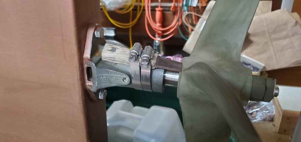

All I have to offer are my anecdotal observations, and one weed beating hack.

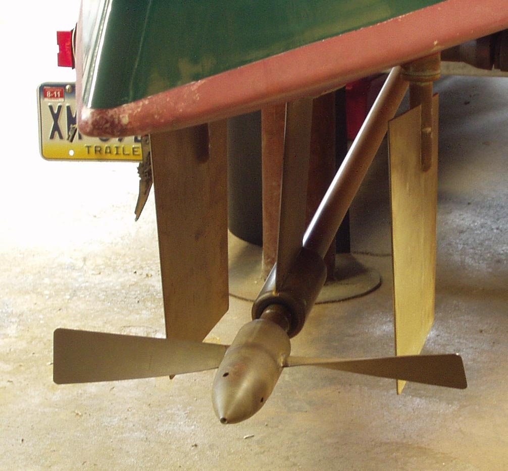

On my first boat Reciproca, the propellor swung in open water behind the rudders, and without any structures nearby to offer resistance, her prop was a magnet for every weed in the neighborhood. I was impressed to learn that the load on the engine stayed exactly the same from swinging a ball of weeds as it was driving the boat forward. In weed infested waters, the engine RPM remained exactly the same as the boat slowed more and more to a complete stop. Repeated reversing of the engine had little effect in ejecting the weeds, again I believe that was due to the lack of stationary structures near the prop to add resistance to the weed ball's rotation. I would have to lie prone on the rear deck, and pull the weeds off by hand, often dealing with a ball the diameter of the prop.
My current boat Vividus, is of conventional design, similar to your photos, and has an Elliott Bay propeller. From the start, she has had much less trouble from weeds, and ejecting them by going full astern is pretty effective. I believe that this is due to the dead wood, skeg, and rudder, all of which provide resistance to hitchhiking weeds freely rotating with the propeller.
The final few weeds that she would be stuck with are effectively dealt with be a hack I learned from Mike Condax. By adding a double edged weed cutter to the stern bearing housing, which takes care of any weeds trying to wrap around the shaft, I virtually never see a weed on my propellor anymore. The source for my blade? An old steak knife.

Kelly:
I like that weed-cutting solution! Simplicity at work.
I am now inspired to add a similar weed cutter to my boats' prop.
Thanks for sharing.
