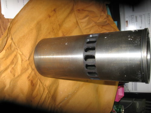

Some steels are difficult to get a good cylinder finish, and generally perform worse than iron cylinder liners. I have found that the typical pipe steel or tubing steel (such as ordinary A178 boiler tubing) is not too good for a steam cylinder.
You could consider machining your assembly and using a diesel engine liner, pressed into your weldment. Cylinder liners matching your size requirements show up all the time on e-bay, with low prices. Be sure to stress relieve your weldment before machining, or else you will have a hard time getting reasonable machining tolorances. Stress relieving vendors are everywhere, and the cost is nominally low.
The attached picture is a liner currently on e-bay that probably could be adapted to your needs, although it is smaller than the one you plan. However the right size liner will show up fairly quickly if you can accept a bore that may be a little more or less than you originally planned for..
- About 4 inch bore iron liner
- CYL LINER.jpg (26.86 KiB) Viewed 23316 times
