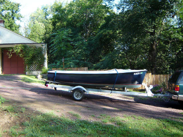

Not knowing what type of hull you are offered, you may want to consider the following:
Many a good centerboard sailboat hulls, 14 to 20 feet length, are available for next to no money. These can be easily converted to propeller drive and are well suited to steam or electric propulsion. I bought an O'Day Javelin bull, with trailer, on e-bay for $107, and made a nice inboard propeller driven (14 inch prop on a 14 foot boat, good efficiency) boat with one week's labor. These sailboat hulls go so cheap because they have bad sails, no sails, a broken mast, etc. There is a detailed review of this building process with many pictures on the internet.
Many of these sailboat hulls are a reasonable approximation of a steam launch hull, with a plumb stem (or nearly so) and rounded bottom, much better than a typical powerboat hull that has hard chines, and way too much beam. The attached picture is the $107 boat/trailer after conversion. I am in the process of now putting a steam plant into this hull, after using it for 7 years as an inboard electric.
- Converted Sailboat Hull
- javelin electric.jpg (75.22 KiB) Viewed 15512 times
