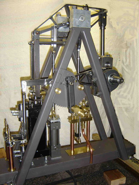

As far as a long stroke sternwheel riverboat steam engine goes, these can be made up without castings, for example, look at the walking beam sidewheeler engine on my boat, all made without castings. The walking beam engine is different from a sternwheel engine, but the use of a similar process can easily be applied to a sternwheeler engine.
- WalkingBeamEngineSmallest.jpg (59.62 KiB) Viewed 17116 times
