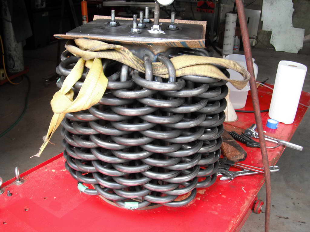

OK, After PLYING my friend with some good scotch he showed me how to shrink a photo; so here is a pic of where we are today; a blend of Illingsworth and olfelt
Re: Olfelt
Nice!
How did you bend those coils?

I think I could wind those tubes without problem, and probably weld them to the centre drum as well.
I've always had a question about Ofeldt boilers though: if one of those tube welds starts leaking after a period in service, is there any way you could get to it to replace the tube or even just reweld it?

My friend Bruce has a LARGE lathe so no problem as far as replacing coils..... good luck. Yes you can get in there to repair a weld but pretty impossible to replace a coil with out MAJOR surgery

That's quite an impressive job, Ron. Very neatly arranged. I bet the thermal efficiency will be on the high side.
Any chance to get another pic of your boiler, taken from above? I'd like to have a look at the coils and the downcoming inner tubes.

Pics before welded into drum, downcomers have to be assembled in two parts into coils BEFORE they can be installed into drum otherwise no way to install them !
coils 2.JPG (81.01 KiB) Viewed 14086 times

Thanks for the pics, Ron. Definitely an impressive and neatly arranged work.
