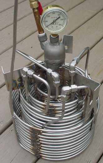

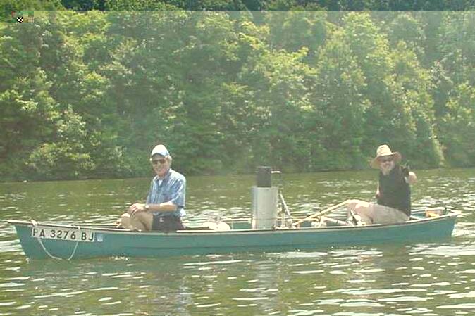

About a decade ago I built a steamer similar to your ambitions, a full description and pictures can be found under "Scanoe Steamboat" in Radow Rainer's website, ( http://www.steamboating.de/ ).
It is one of only a very few car-top transportable steamers. A Coleman Scanoe, which is a 15 foot long square stern canoe is the hull, fitted with an I/O drive system, using an outboard lower end. I had a converted chainsaw engine converted to steam service, using the original crankcase, crank, connecting rod and piston, with steam top end built primarily with pneumatic cylinder parts. The boiler was monotube, with a steam/water separator vessel on the outlet of the generating coils.
The Scanoe Steamboat was however fired with propane, which in my view is a real advantage to allow proper adjustment to match flame heat to engine steam consumption. Have a look at Radow's website. If you like additional details will be posted here.

- Scanoe Steamboat Underway
- scanoe.jpg (56.18 KiB) Viewed 28968 times
- Scanoe Monotube Boiler
- Sca-boilcoil.jpg (20.14 KiB) Viewed 28968 times
