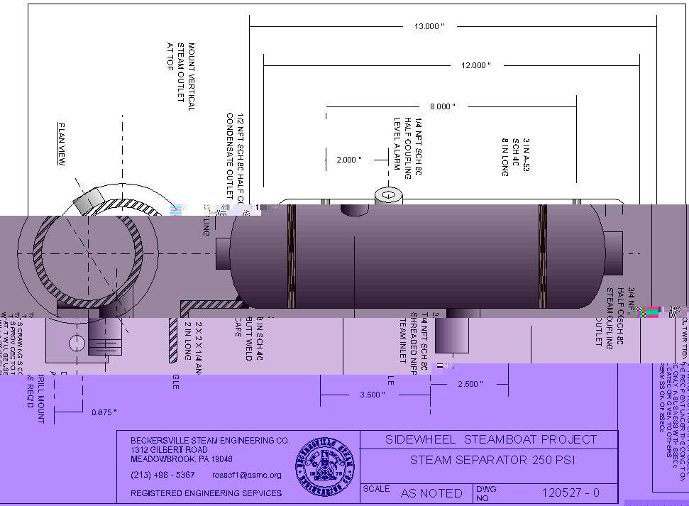

This separator could be built without great expense at a pipe/vessel fab shop.

Thanks for the drawing Fred!!!!
Re: Steam Drier
I am having this quoted....
Fred: The material A53 Type S?
In your drawing you label A-53 and sched 40 and sched 80 but they are asking for the exact material.
Re: Steam Drier
A-53 Pipe, Type S (Seamless) is best, ERW (Welded Pipe) is also OK, and usually much less expensive. With USA made pipe, the welded stuff is generally very good quality. I would recommend you specify USA made pipe for anything you have built. For the half couplings, A-865 is OK, A-105 is premium. Full penetration welds required, and I would avoid MIG welding, although several shops can do pressure vessel welds with MIG in the higher amperage/larger wire range.
I always specify A106 Seamless Pipe for the main pressure vessel parts of a steam boiler that is being built to the ASME Code, although A53 ERW could also be used. However if you use welded pipe, then the longitudinal seam weld needs to be radiographed, which generally costs far more than the price difference between welded and seamless pipe. For the last boiler I had fabricated, the welded pipe shell (16 inch OD x 3/8 wall, 18 inches long) cost was $78, and in seamless pipe $314. But the radiography cost was $1500, so buying the seamless pipe was a "no brainer".
Those are part of the ASME rules for a fired boiler.
The separator shown above is not a fired boiler, so the rules are far less demanding. The sketch I provided is not designed to ASME standards, but I would have no fears of hydro-statically testing it at 750 psi.

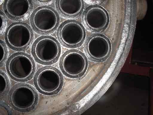

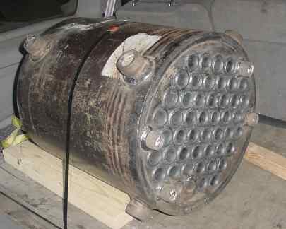

- Completed Boiler Shell, $890
- 890USD.jpg (12.83 KiB) Viewed 7108 times
- Automatic Welding, 48 tubes
- 890WELDS.jpg (21.39 KiB) Viewed 7108 times
