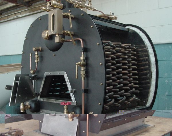

For a canoe, you might wish to consider a more horizontal boiler; something along the lines of the Blackstaff design would work pretty well. Given that you want to use wood, I'd see if a all-steel Ofeldt is practical, since boilers w/ copper coils are quite sensitive to water level. Winding the coils from 1/4" pipe should work; certainly the experiment there seems worthwhile and inexpensive enough if tried in the home shop.SL Ethel wrote:Does anyone have any data or experience to share with regard to fire space in a small wood fired boiler?
My larger boiler (18" diameter grate, 5hp) had 16" from grate to tubes, and this seemed to work well, but it would be problematic for the little boiler I'm putting together for a canoe plant.
Current plan is for a 12" diameter grate, with an Offeldt pressure vessel above. Fuel would normally be 1.5" square cedar sticks (4x4 cedar fence post off-cuts). I am thinking about making up a fire box that extends 10" above the grate, with another section of casing above that which would support the pressure vessel. That would make it fairly simple to raise or lower the pressure vessel over the fire to experiment with the fire-space.
Is anyone else firing with wood in tiny boilers? I would love to hear your experiences.
Thanks,
Scott
- Boat_Boiler.jpg (52.66 KiB) Viewed 12838 times

Re: Fire space for solid fuel firing
Bart,
Thanks for the response. The horizontal Ofeldt certainly appeals from a height perspective - I'd like the boiler not to tower above the gunnel. And in the canoe, there would be no objection to making it very wide (relatively speaking). However, I've always been suspicious about the flow path for the combustion gas in such a boiler. From the pictures, it looks like most of the gas would pass up through the top of the coil stack without actually passing through most of the turns of coil. Is there usually an internal baffle? Or does it turn out not to matter that much? I've read Cliff Blackstraffe's article on these in SMSL (which looks a lot like the picture you posted).
Do you know if anyone is running something like this in a small size with wood fuel?
Cheers,
Scott
Cheers,
Scott
Hi Scott -
The advanced search here is useful: http://steamboatassociation.org.uk/page-1117882
I can find one boat w/ a Blackstaffe boiler that is coal fired. I think a stainless baffle over
some economizer tubing would handle any errant gas flow issues - certainly easy enough to do,
Keeping the weight low is really nice in a narrow boat - they can be exciting enough w/o tall
boilers.
