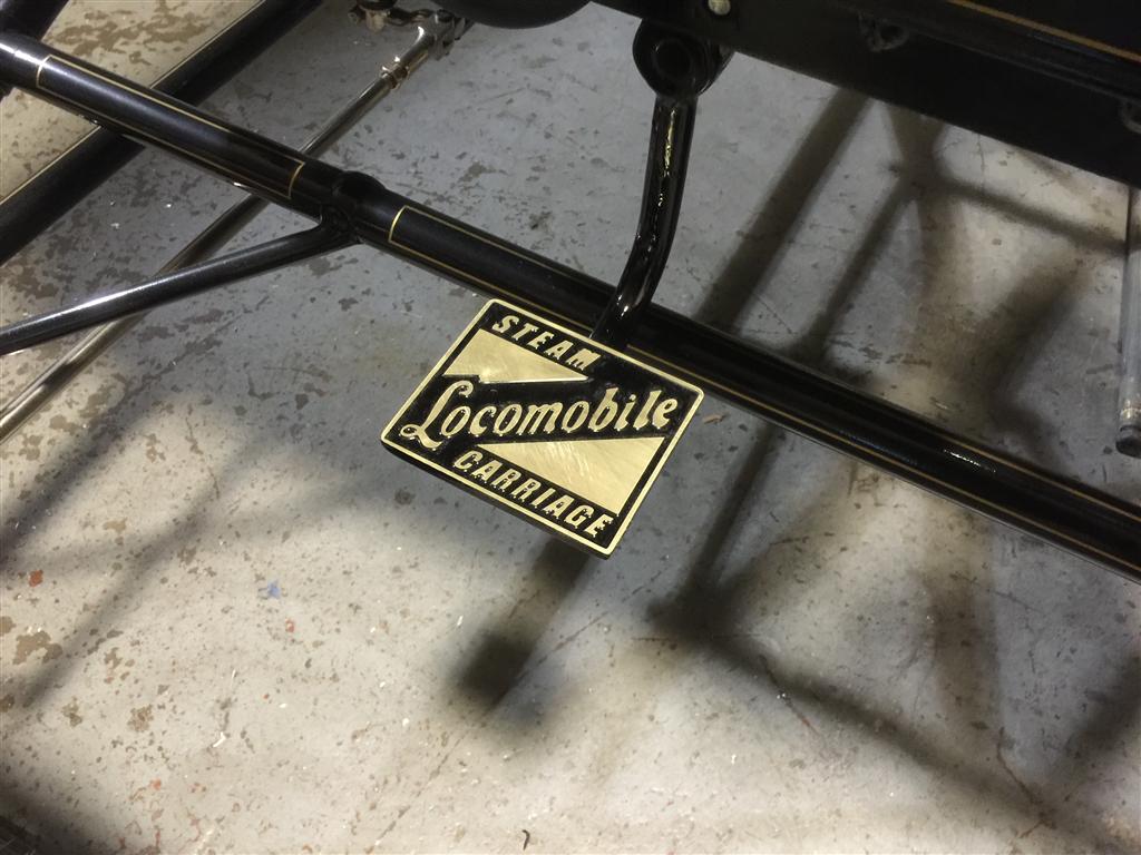

This is black wax crayola on this gauge, it's been in there about two years.
The source you provided is from some blogger, and I don't think he knows what hes talking about, every website refers to "melting the wax" If it were just shellac it wouldn't melt and they wouldn't call it "wax". They put shellac over the wax to seal it and that is probably referring to having a hard surface.

When I re-waxed my dials, I didn't heat it up, I just took the crayon back forth over the engraved pocket until it was full, then I buffed it out with a heavy piece of leather smooth top side down, that prevented removing the wax.
