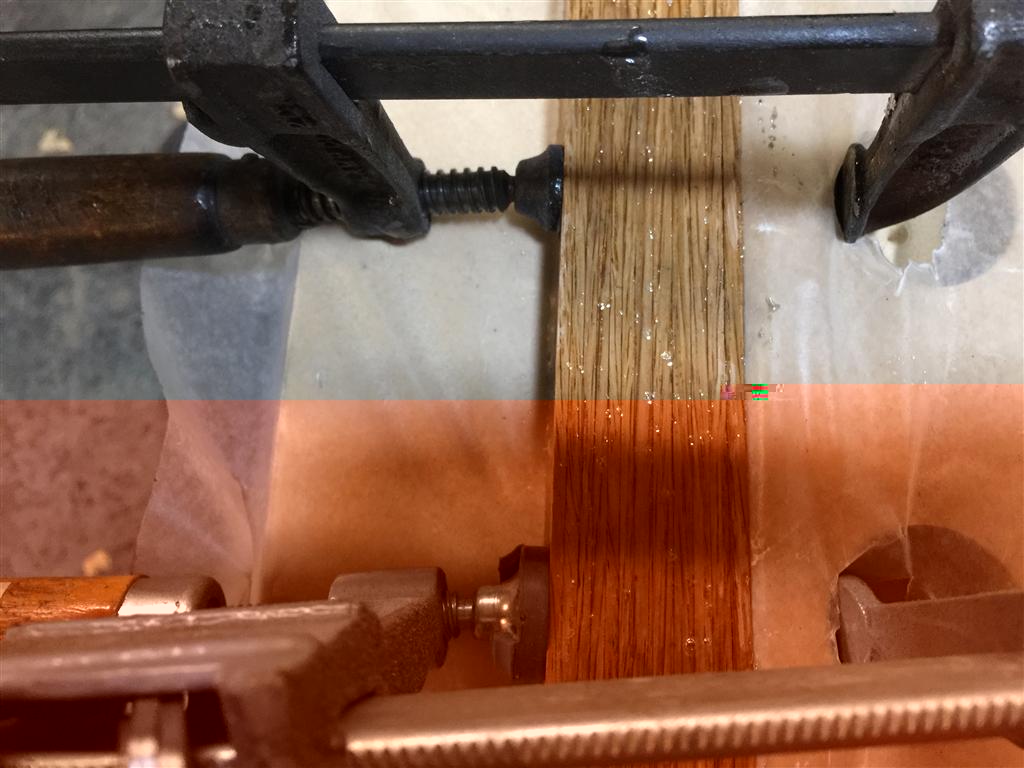

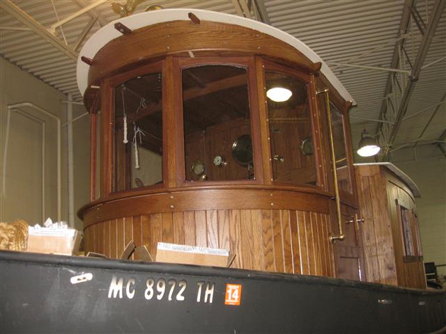

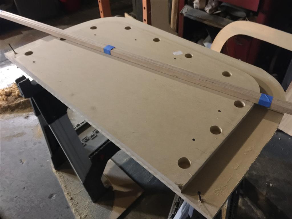

"I don't get how they get them to curve that sharply"
If the veneer is thin enough and good wood and correct moisture, it can literally be tied in a knot. On the tug I used 1/4" thick white oak lams for the arched pieces in the front of the wheelhouse. A seat I built for an ongoing steam carriage restoration shows a much tighter radii in the laminated white oak armrest and 1/8" birch ply construction
- IMG_2288 (Medium).JPG (95.63 KiB) Viewed 17720 times
- IMG_2272 (Small).JPG (26.24 KiB) Viewed 17720 times
- IMG_2283 (Medium).JPG (76.58 KiB) Viewed 17720 times

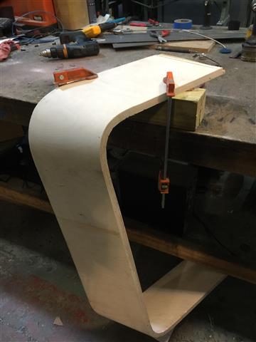

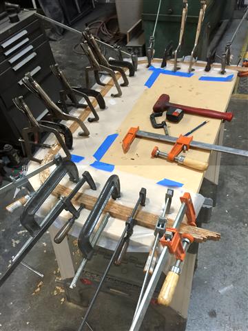

Re: Jay R. Benford 25ft Fantail Launch
More pics
- IMG_2284 (Small).JPG (46.46 KiB) Viewed 17720 times
- IMG_2845 (Small).JPG (50.98 KiB) Viewed 17720 times
