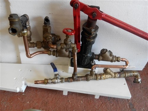

The context is that I am re-plumbing Frances Ann from being a puffer to either puffing or condensing. In puffing mode one launches, opens the lake feed cock and then works on one's musculature with the hand pump until there is water in the glass.
If one goes somewhere in which the stuff you are planning to float upon is not something you would like to introduce to the boiler, what do you do? I am wondering if it might be worth adding a spur to the lake feed line with a hose connector fitting on it. One could then use the local water supply to fill the boiler. If it was positioned upstream of the hand pump, it would not matter if the local water pressure was low, or if the supply was coming from (say) a rainwater butt.
Having finished steaming and pulled out the boat, if one is a puffer one can simply blow down to empty the boiler and tow home with an empty boiler. If one condenses, what on earth does one do with the hot well, condenser, etc? Do they live their lives full of water?
Your observations and experiences would be appreciated.

Many thanks for your useful comments. I will go ahead with the reserve tank idea, and see if I can set that up so that it will also allow a hose supply (Test steaming on the drive?). I doubt if I will get space for 15 gallons - there is a locker that might hold 10 litres... Sod's law applies of course as I have not long completed a rather convoluted bit of plumbing for which one of the elbows will now need to become a tee. Hey Ho!
Lake feed as seen from the site of the boiler.
Lake feed system (500 x 375).jpg (50.78 KiB) Viewed 16959 times
