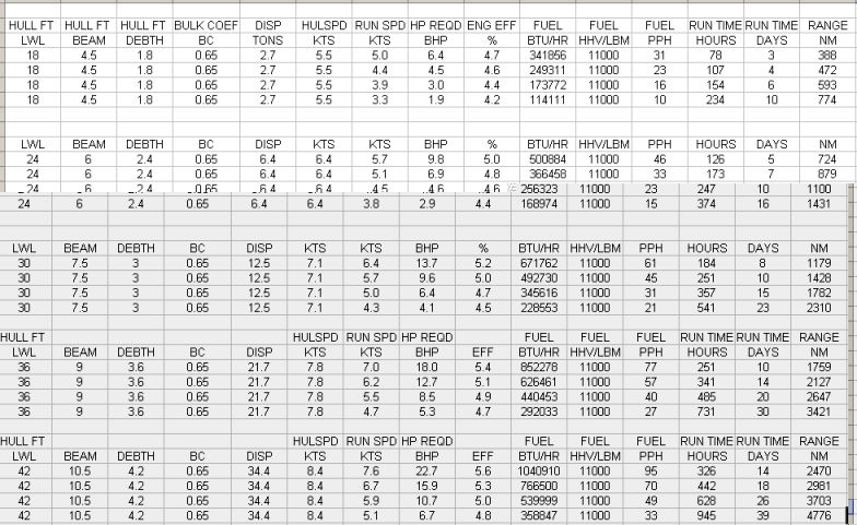

FROM MIKE: "I wonder what the minimum size steamer (assuming a reciprocating engine and any fuel) would it take to cross an ocean?"
I did some quick and crude calculations here, for a heavily laden steamer hull, with 40% of the hull displacement as coal fuel, running a very good condition steam plant, at various fractions of "Hull speed".
The ranges and run times are calculated, but if only 20% of displacement is fuel, then half those values. If good wood fuel rather than coal, then half again. Steam plant assumed efficiencies are optimistic, but attainable with a well arranged reciprocating plant.
- STEAMER RANGE 40% FUELa.jpg (110.61 KiB) Viewed 24785 times
