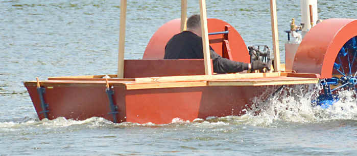

Transom mounted rudder shafts of the Margaret S. They have tiller arms piercing the transom at the top, with steering connections all inside the hull. This gives 90 degrees of rudder turning, with only 3/8 inch x 3 inch holes at the top of the transom.
These rudder shafts are made from pipe, with a common hinge joint near the waterline, so the rudders can fold up and then I can back onto a beach. When underway, wood dowels are inserted straight thru the the pipe shafts, to keep the rudders well submerged. If I hit something in shallow water, the dowels break, and the rudders fold up, no harm done. When exploring shallow inlets, I usually break a couple of dowels. This is a handy feature when the rudder(s) are the deepest appendage under water.
- sternrudders.jpg (29.67 KiB) Viewed 13223 times
