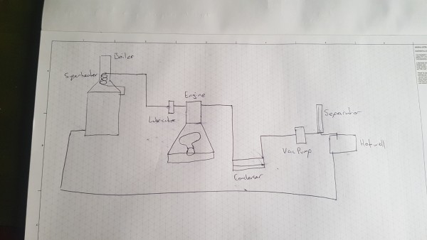

Im planning slight super heat and like tinkering with the boat
attached are some drawings of what im thinking.
one being the separator design, a capped end and the other a removable cap with the inlet and outlet to allow filter medium to be refreshed. Oil floats on water but I figured if the water was forced through the medium this wouldn't be critical to the design and will allow it to be mounted vert, hoz, up, down, left, right etcc.. The vacuum pump (not yet built) will (I assume) provide some positive pressure to force the condensate through the medium..
Thoughts?
I understand there are parts missing from the "architectural" drawing but I think it gets the idea across.

What works for a lot of people is to have a layer of Oilsorb on top of the water in the hot well and have the hot well float valve outlet dumping on top of the Oilsorb.
Backing up a bit, I don't see a hot well float valve in your piping diagram. Without a float valve you will be constantly fussing with the boiler water level. Don't leave home without it.
These have been around since Noah and a boat without such a system is a fiddly and aggravating proposition.
