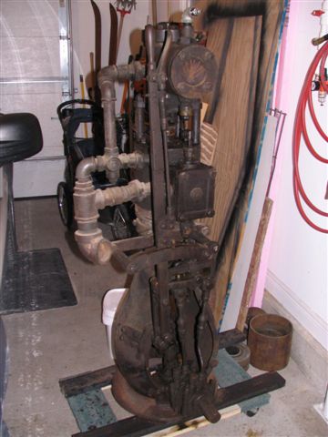

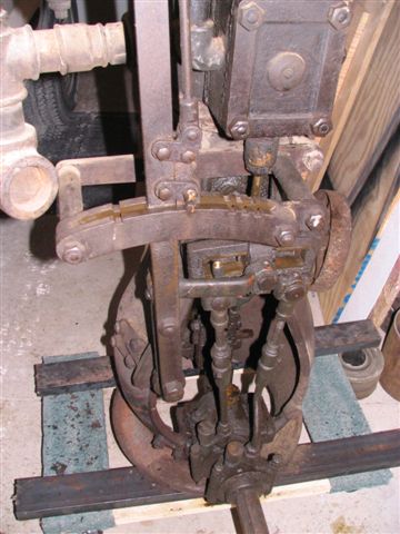

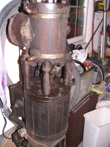

I have a coke bottle steeple compound steam engine with stephenson link reverse. It has a 3" bore by 6" stroke HP cyl. and a ? 5-1/2" bore by 3" stroke LP cyl. I was told it was a marine engine and came off a boat from the great lakes.

Is it a marine engine? If so what size boat would it fit?

Make that HP cyl 3" dia, Lp Cyl 5-1/2" dia, Stroke 6" It turns over pretty nice, but needs a flywheel. I have ordered a 11" dia by 5" thick cast iron round to make one. I figure it will weigh about 125 lbs when machined.
