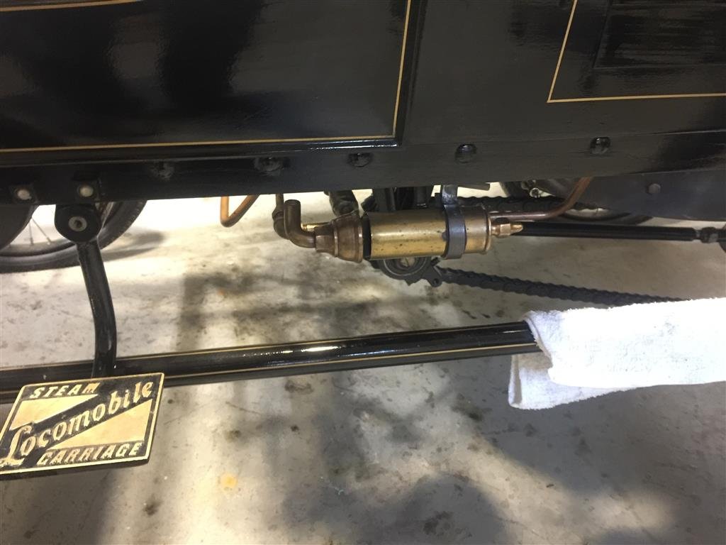

I have an original whistle from a steam launch, it's on my Locomobile car of all places. It is a 3 chime, 1-3/8" diameter body with 1/4" pipe, the elbow at the base suggests that it's steam line ran inside the stack (which would combat the condensation issue by keeping the line hot). The whistles that modern day steamboaters are using were for traction engines etc, much larger boilers. Just a sidenote, the steam cars never had whistles as they would scare horses. When in Rome..
- IMG_1539 (Medium).JPG (96.6 KiB) Viewed 8302 times
