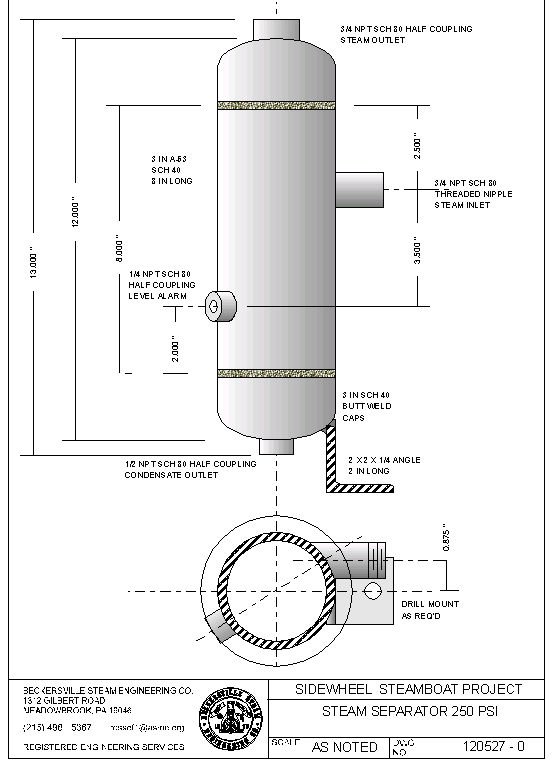

Large plant practice dictates a steam/water inlet, tangential to the vertical main vessel, about half way between top and bottom. Vessel steam upflow velocity 3 feet per second (about 1 Meter per second), with minimum 1.5 main vessel diameters above for steam outlet, plus 1.5 vessel diameters below to water level.
The attached file is a separator tank on my steamer, used only to protect from water carryover if the boiler primes. The bottom outlet leads to a steam trap, which is fitted to discharge any water accumulation.
- MS-SEP.jpg (68.57 KiB) Viewed 8480 times

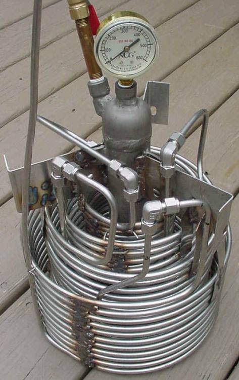

As always, many thanks. This is exactly what I was hoping for. By the way: Do you think your steam is very dry already? (In your "machine gun" monotube) I am asking because I was thinking of placing a cyclone separator inside the top of the flask. It'll definitely not hurt, but if the tangential inlet already works out fine, I wouldn't need to braze one together.
Re: How to design a monotube steam separator?
"Do you think your steam is very dry already? (In your "machine gun" monotube) I am asking because I was thinking of placing a cyclone separator inside the top of the flask. It'll definitely not hurt, but if the tangential inlet already works out fine, I wouldn't need to braze one together."
The monotube boiler in the canoe produced saturated steam, close to 100% Quality. All of the steam generating tubing was constantly kept with significant amounts of liquid water flowing in a mixture with the steam. This design assures that tube burnout or overheating would not occur, and needs a separating device obviously.
Many monotube boilers attempt to match feed flow to steam generation, with close control needed to avoid sending liquid water to the output pipe, or to avoid excessive steam temperatures, which can also damage an engine, and/or cause boiler tube burnout. Getting adequate control with this type of system has usually led to failure.
The effectiveness of steam/water separation devices is a technology already well developed, and yes, a centrifugal separator will improve efficiency of separation. The salient question here is: How well does the separator with the tangential inlet work, vs adding another complication? Just making the separator tank somewhat larger would accomplish the same result, but quantifying the benefits would take either some heavy calculations, or testing under controlled conditions.
