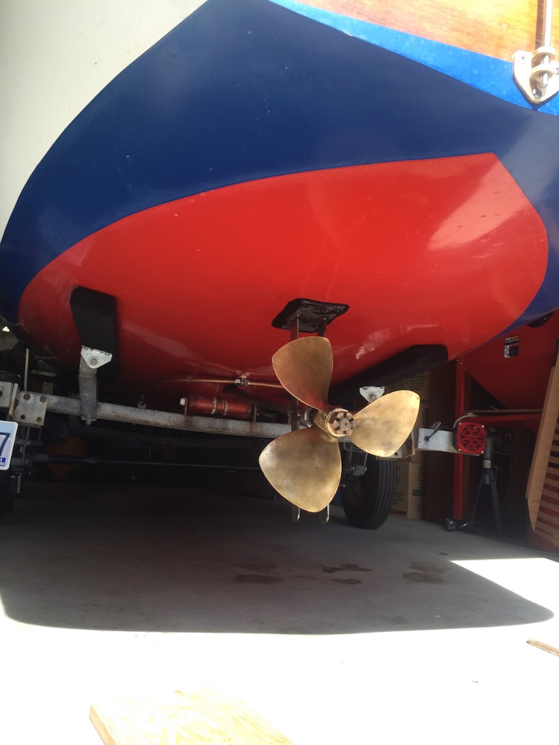

I am considering installing a depth sounder on my 17 ft. steam launch hull.
It is 1/4" to 3/8" thick mahogany, cold molded, and fiberglass covered inside and out.
I would prefer an internal mount for the transducer, rather than through hull.
Because this is a Thistle sailboat hull with no keel and a planing configuration, the shaft, prop and rudder are exposed to damage.
The prop does have a stainless steel protection structure ahead of it, but that's all.
A forward-mounted depth transducer seems like a good instrument to have.

Lowrance makes some very nice units with forward-looking sonar, but the transducer is through-hull (actually easy to pull while in the water to wipe slime off). We have one on Persistance as when one draws almost 6 feet of water and plys the waters of a tidal delta it is wise to be looking out ahead. Wouldn't want to run aground at high tide...
I'm not sure if they make any forward looking units that can be mounted inside the hull.

Any possibility of adding a bottom support from your rudder to the strut? For prop protection.

Thanks for your suggestions I will research forward looking devices. That is my preferred solution.
Transducer mounting? I'll just have to see what works. The bow section is near vertical making it difficult to mount thru-hull transducers.
Mike:
The rudder on my launch is hinged on the transom only. No lower supports.
So it is unable to support struts on the bottom, without major design changes.

I wouldn't get too worried.
Otter's prop has been 'hanging low' w/o even a preceding skeg for the almost 30 years she's been steaming. Yes, I've grounded the prop on a rock a time or two, but nothing really bad that a bit of light filing didn't clean up. I do stand and slow down when steaming in shallow, rocky water for better visibility; those struts really only help on gently sloping bottoms. It's quite possible to 'sideswipe' a rock as well. If unsure of the bottom due to murky water, a boat hook or paddle will serve to investigate. These small boats draw less than 2', which is easily reachable.
Depth sounders can be useful for navigation w/ a chart, watch and tide table, but on a small boat a tablet and/or phone w/ Navionics software and gps is pretty unbeatable.
