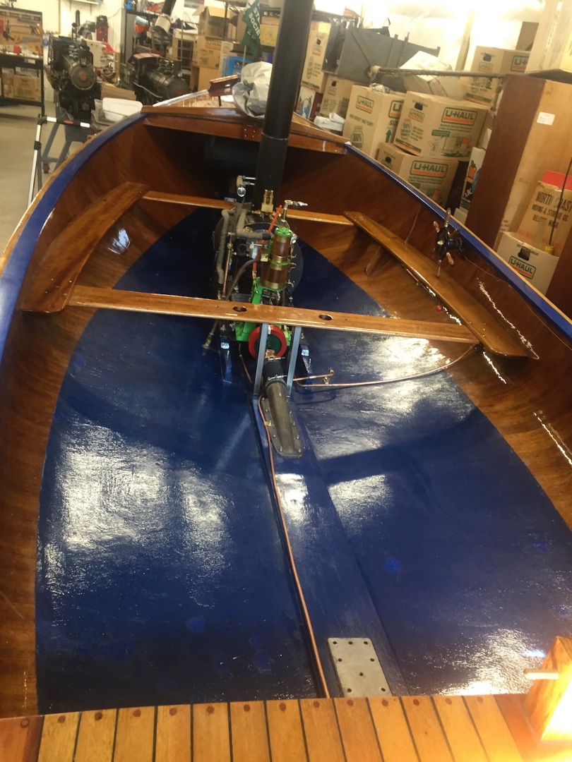

Yes, Thistle hulls are not tiny:
17 feet long by 6 feet wide, with a flat bottom planing hull.
And our boat moved along nicely.
Looking forward to further testing, in lower winds...
