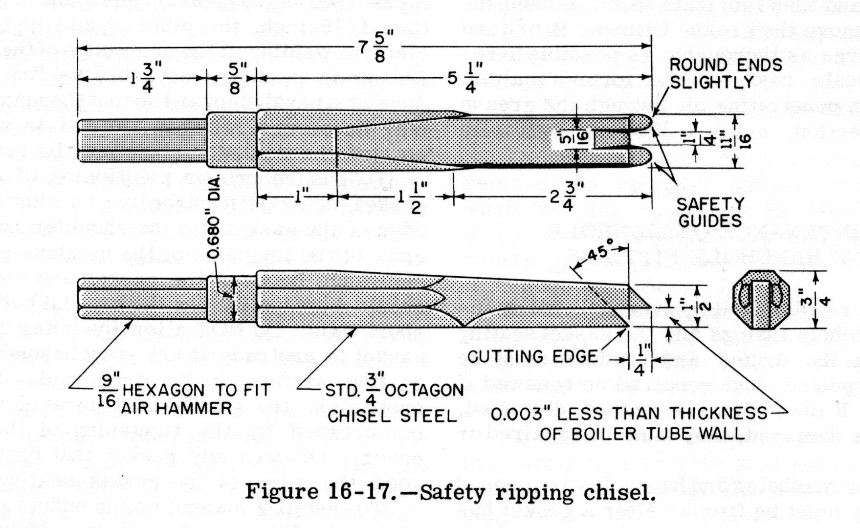

Re: Removing boiler tubes
https://www.youtube.com/watch?v=vqnMJmjtvGw
This might be a little over the top, but on a smaller scale the operation is much the same. Instead of a plane round nosed gouge a " safety ripping chisel " was used by the boilermakers when they removed a tube for inspection on the ship I was on. The tool is ground with the sides cut back allowing only the center to cut just less than the thickness of the tube wall. Hard to explain clearly, I'll see if I can find a drawing of one that I can post.
Dave
I found it much quicker than I thought it would be. A little work with an angle grinder and a standard chisel could be modified. May not be worth the effort if only a couple of tubes are involved.
Good luck
Dave
