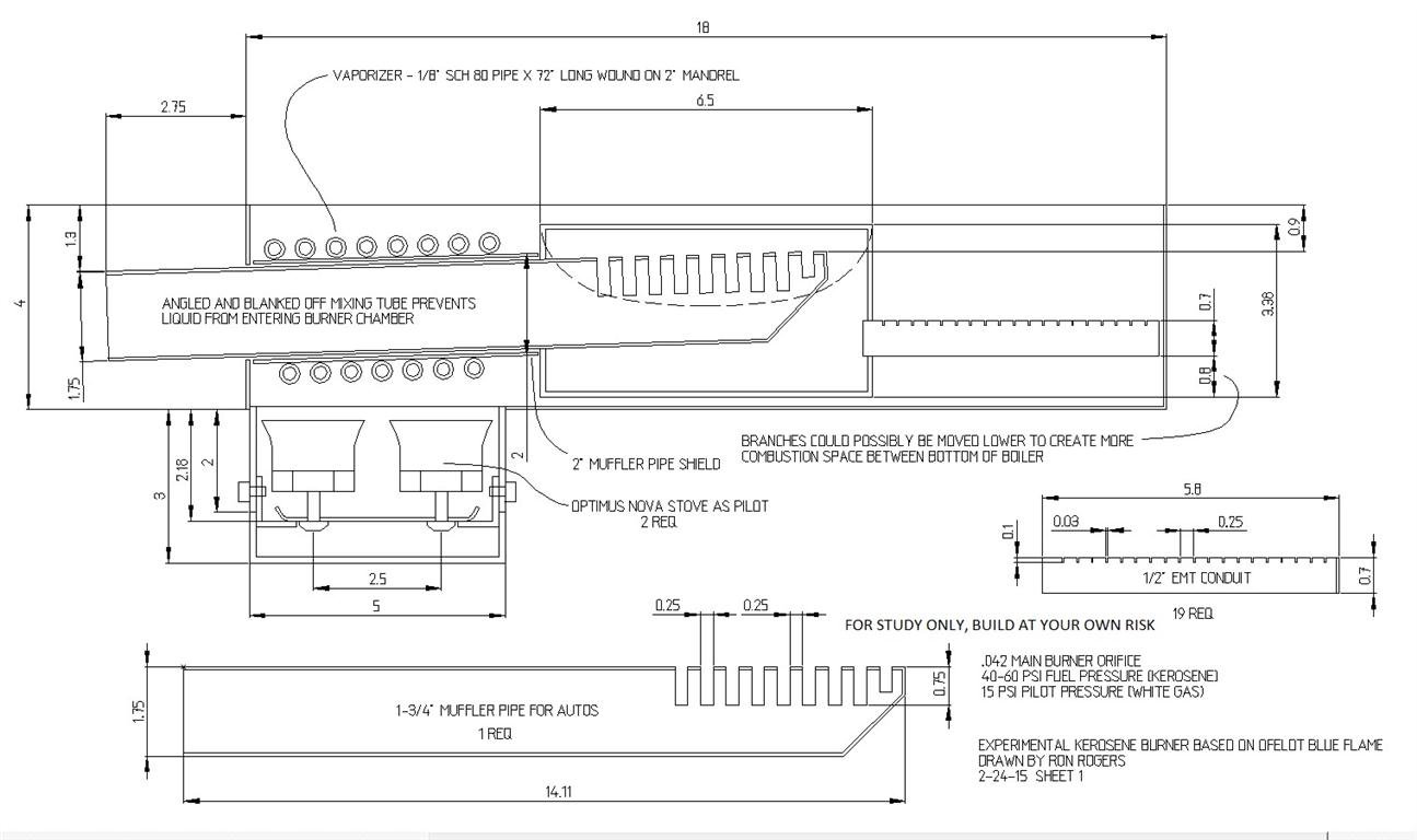

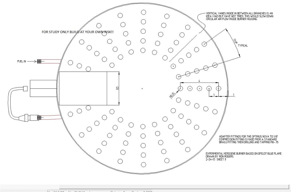

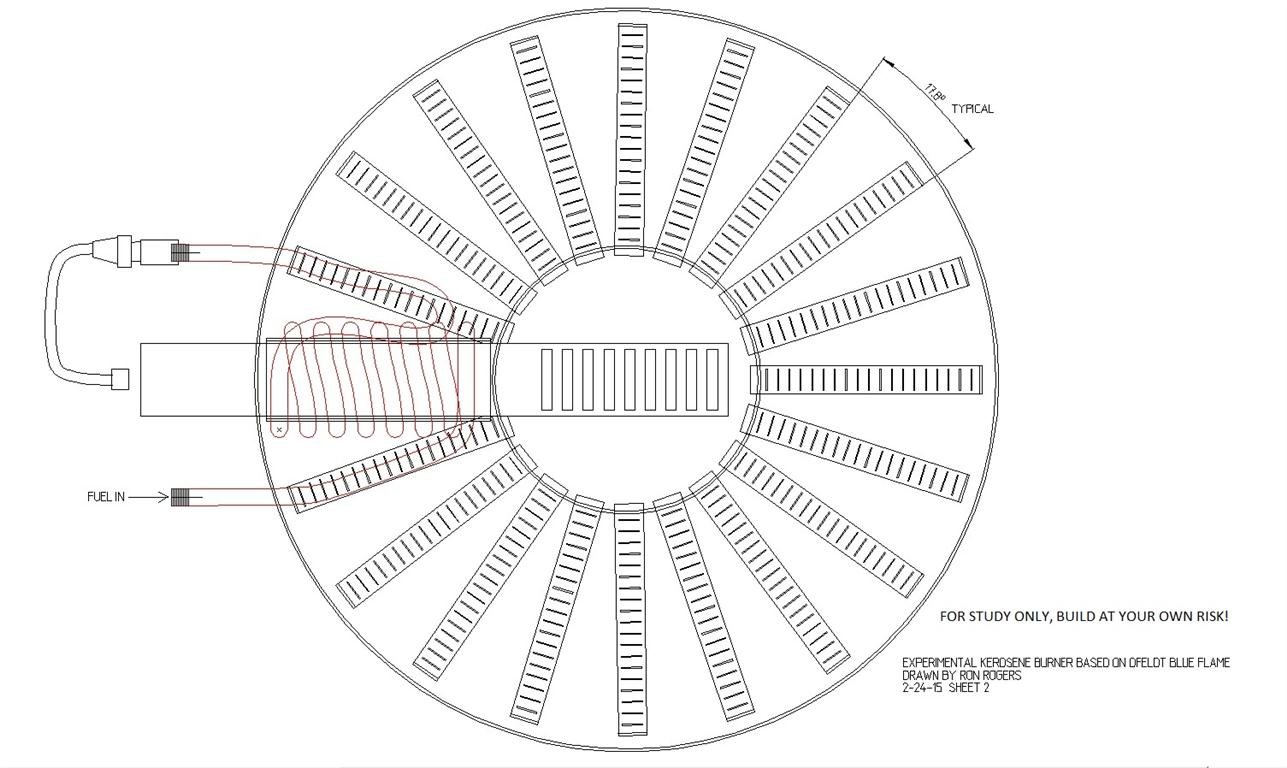

The burner I use in my steam car is of the Ofeldt design. It is very quiet and puts out 300k BTU, can be easily scaled up and down. Works on Gasoline, Kerosene propane etc using different jets. The drawing shows a vaporizer but it wouldn't be needed for propane.
It is made simply from EMT Conduit and a bit of 16 Ga steel. Dirt cheap to build. the pilots I used are rather expensive. Slot width is critical and they can be made with readily available narrow hacksaw blades (and a lot of hacking).
I would not use one in a boat with pressurized volatile fuel, especially gasoline. It would be fine on propane though.
One thing to keep in mind about propane, is that it is heavier than air so it will lay low areas like the hull of a boat. tanks on a boat should only be stored in a locker that is vented outside the hull.
Side note: the mixing tube and body we call the banjo, the mixing tube can come up from underneath with a 90 degree elbow, that works. one has even been built with two mixing tubes with elbows from underneath. On our buggy designs we are very limited for height. We have about 23" in between the drive chain and the bottom of the seat. in that, needs to be a 300k BTU burner with adequate combustion space, a boiler, an economizer, a plenum over the boiler and adequate space for insulation and a bit of an air gap so as not to set the seat on fire.

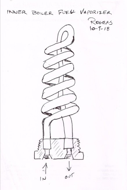

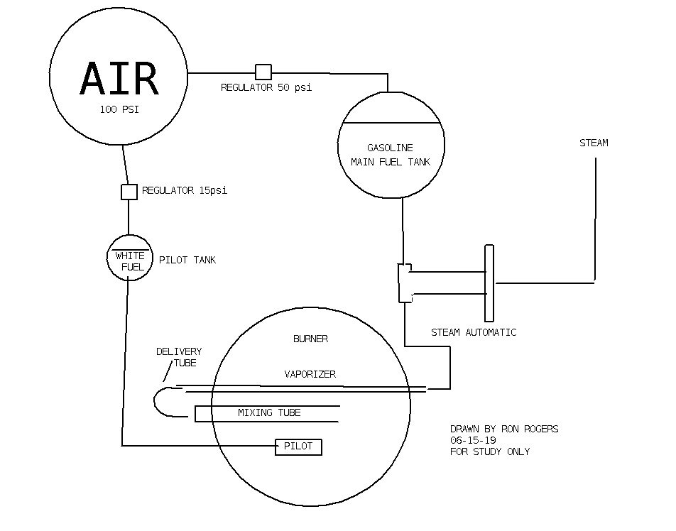

More info: basic fuel system diagram
My idea for an internal boiler fuel vaporizer. Steam temperature at 250 psi is perfect for vaporizing gasoline without cracking it to carbon. Have to start with wood or propane then switch over when the boiler is up to temperature.
