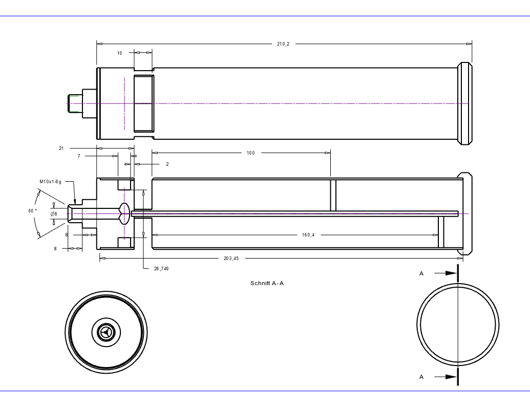

Hi,
the whistle is finished. The sketch shows the dimensions.

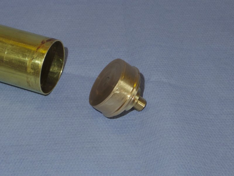

The base and steam distributor is turned and milled.

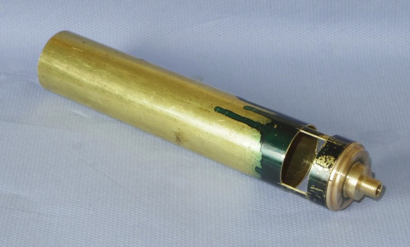

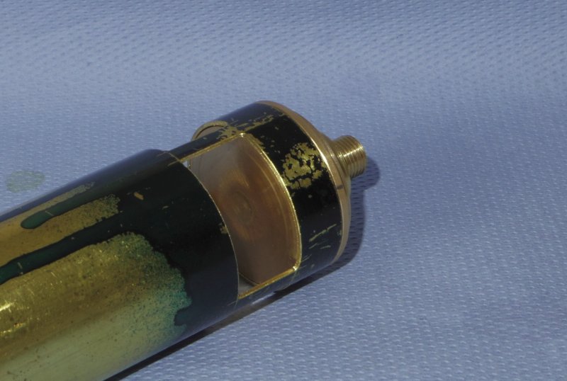

Hi,
some more pictures.
The windows in the tube were milled and the sharp corners were filed.
The small slot for the steam.

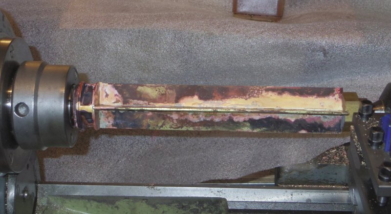

The three parts of the spider were soldered together. The procedure was more easy then expected. Three slots were milled into the base and a second part with also three slots held them in place while soldering. The diameter of the spider was a bit bigger than the inner diameter of the tube. So i had to turn it down to shape.
some more pictures.

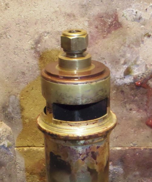

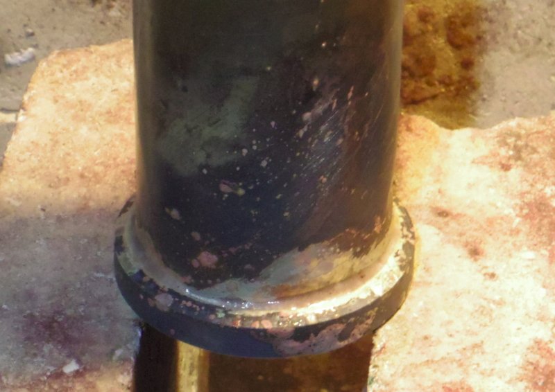

Re: Steam Whistle for a (my) steam boat
Hi,

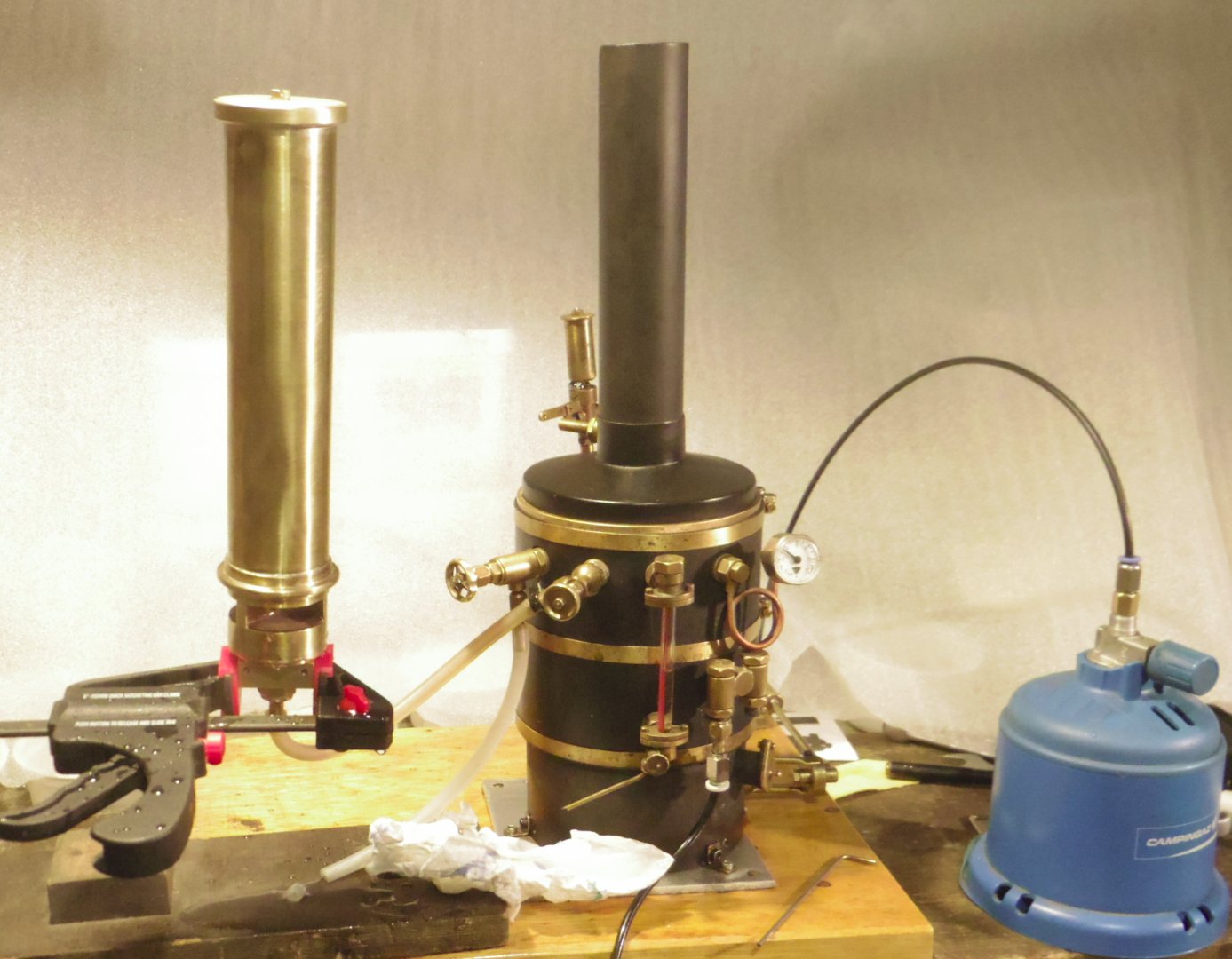

the base with spider and the tube were soldered together with a high temperature soft solder.
Then i have tested it with steam and what did i hear - no sound, just a hiss. I found the cause in the excessive distance between the base and the upper edge of the window in the bell. So i have minimized them to a high of 10 mm. I had to make some parts - a ring made of a sheet metal strip, three sheet metal segments and a turned ring. All them were held in position while soldering with some 1 mm copper rivets.
Three tuning stops were made. Each was set in position, steam tested, and then soldered in.

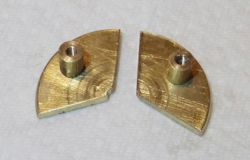

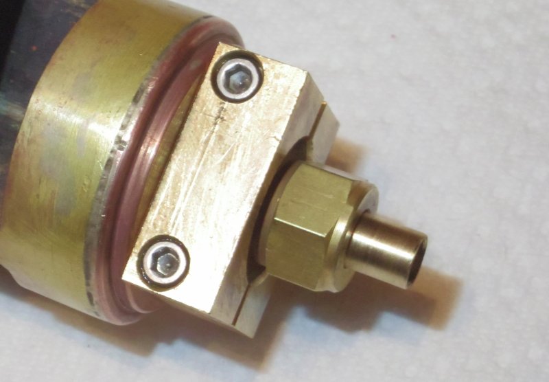

at last i soldered a brass cap on to the end of the tube.
The whistle will be attached with a two-part holder.
