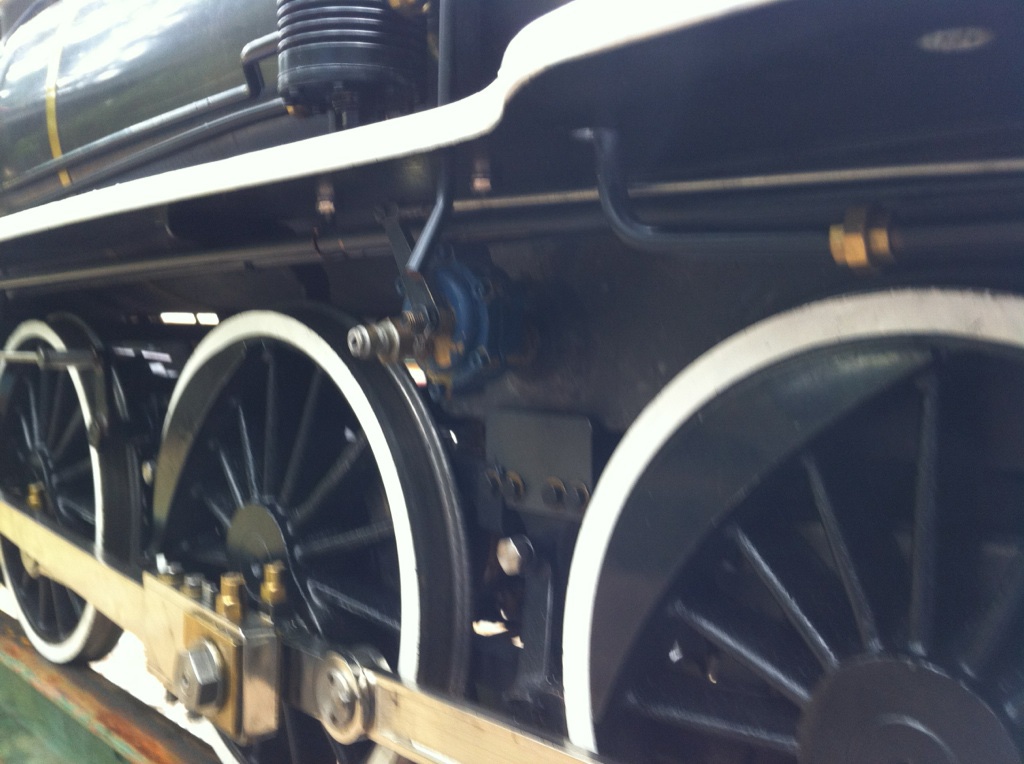

My experience with Everlasting blow down valves was on steam locomotives in tourist service.
Part of annual maintenance was to remove the valve for disassembly and servicing/rebuild, EVERY year.
That was standard Class 1 US railroad maintenance. Food for thought.
I even perform similar servicing on the 1/8 scale blowdown valves on my steam locomotives.
Sorry the photo is not so clear.
I would remove your valve for that complete rebuild. You might find it in better condition than you think.

Spraying lube in would free up the valve, but only until the first time it is used under steam. It is an all iron valve, and thus prone to rust. The best way to keep it happy is to work it every day, and when down for layup, always leave it in the closed position. You don't want the rust ring forming with the valve open, where it intersects the seat. Also, position the valve so the pipe connections are at the 6 o'clock position, with the bulk of the valve above the pipe. If you position it with the pipe at say 8 o'clock or higher (like the photo of the live steam locomotive), the low spot can fill with scale and mud which can tear up the seat, and serve to keep the inside of the valve wet and more prone to rust, not to mention possibly prevent the valve from closing one day.Mfoxchicago wrote: ↑Wed Mar 03, 2021 3:51 amYour thoughts about trying to get some lubrication to the back side of the valve blade?
