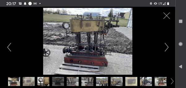

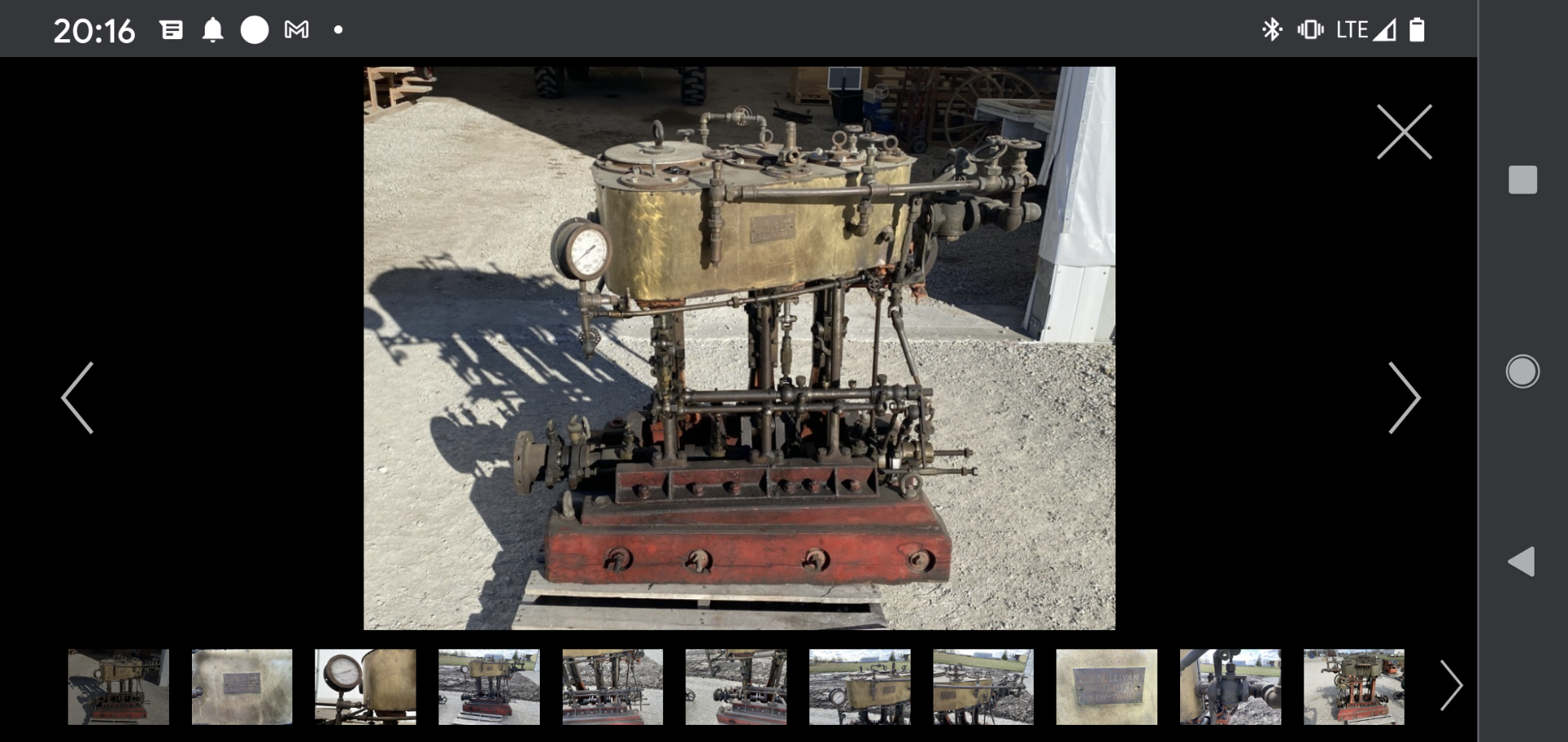

Saw this engine on the interwebs... Anyone know anything more about it?
Seems quite interesting. Slip eccentric with all three eccentrics off the front of the crank and valves activated with layshafts and linkage. Reversing appears to be by lever on backside of engine with rack and pinion to rotate/move slip eccentric collar. Almost appears to be setup for single-handling. Decent size judging by size of valves... I think the throttle is 1-1/2" by the other screenshots I have of it. Plumbers nightmare of valves for the simpling line. Made by Sullivan.

That's a nice looking engine, quite large, for a 30 footer possibly.

From my observations and using one of the valves with a known size as a 'scale' I think the stroke is between 6 and 8"
If so, quite suitable for 30'+
