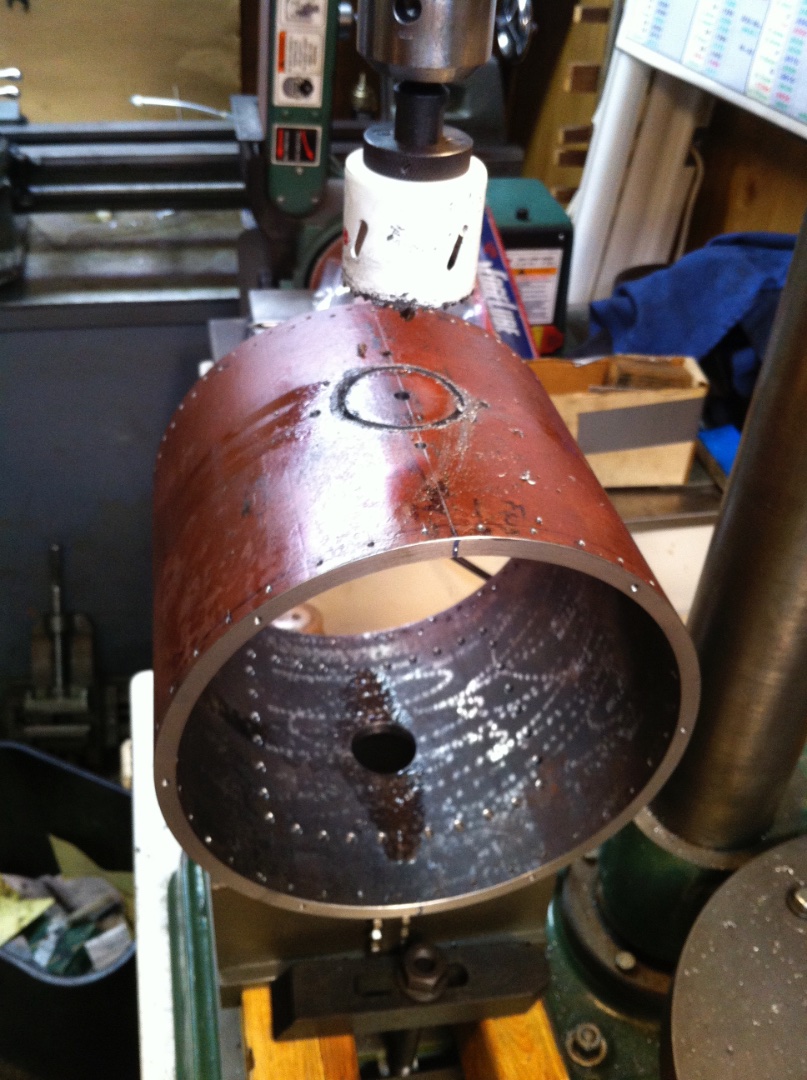

Here's a picture of how I drilled the smokestack hole in a 9" diameter steel smokebox, using my drill press.
This was before I acquired a good milling machine, which would have made the job much easier.
Keys to success:
- Securely clamping the tubing to the drill press base;
- Slow rpm on the "hole saw" cutter;
- Generous use of lubricant;
- Patience.
It worked as desired.
