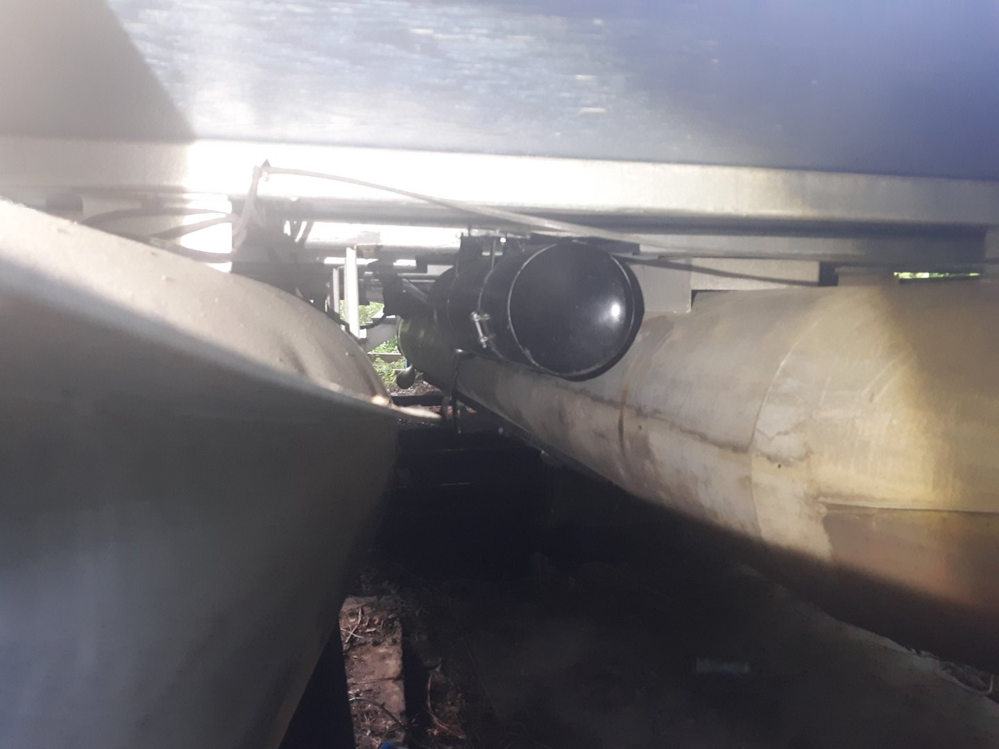

Re: Condensate collection tank
I installed the condensate collection tank below deck between the center and starboard pontoons fore of the boiler by a few feet.
The exhaust from the engine is configurable by a series of ball valves and a few tees.
Engine Exhaust -> Ball Valve -> Armstrong Inverted Bucket Steam Trap -> Swing Check Valve -> Condensate Collection Tank
Engine Exhaust -> Ball Valve -> Puffer, ~0.4" Orifice
Engine Exhaust -> Ball Valve -> Engine Exhaust above deck
(These three are in parallel)
I steamed up two days in a row. Both times the puffer and steam trap ball valves were open the whole time.
The tank has a compound vacuum-60psi gauge and a 30psi safety that pokes up out of the deck (passenger suppression system?).
It's a little hard to read the gauge from the back of the boat, but it didn't seem to vary from 0psi.
Both times at the end I opened the 30psi safety valve and there was a slight snort, so I think it is helping to remove condensate from spraying into the puffer. I do think the tank maybe getting the occasional wave hit the underside.
I have also added insulation to the exhaust line that runs from the engine to the boiler, below the deck - that probably helps minimize condensate generation.
Temporarily I may try to use my electric transfer pump to drain the tank to a bucket above deck when the tank is cold. If I just leave it I'd imagine it would fill with condensate if it's not already full. The tank holds 8 gallons, luckily It's in a perfect location for ballast. I am curious how quickly the condensate actually accumulates. Unfortunately the only way to measure it right now would be to pump it into a bucket above deck.
In the future I am considering trying to use my gem steam pump to see if I can pump this back into the boiler. The takeoff would be at bottom of the tank, and hopefully oil floats on water?
