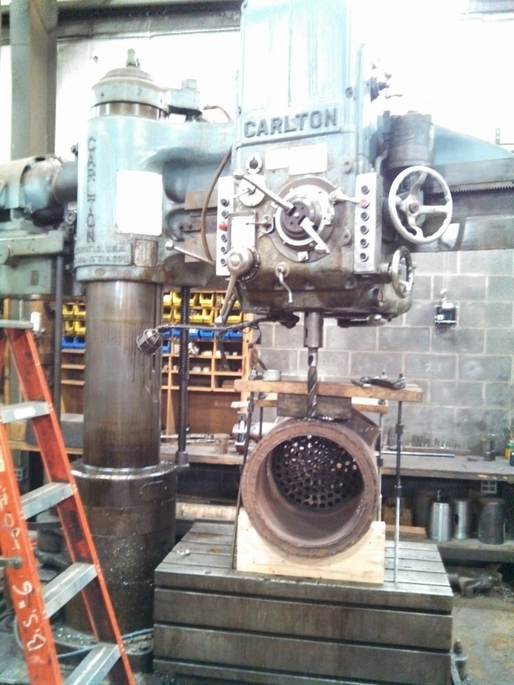

marinesteam wrote: Wed Jun 22, 2022 3:49 pmUsed every bit of the vertical, even with the 4" riser" for the reamer to clear the tube.
So nice to have access to the machine tools at work...
Yes, it is.
Nice setup. Looks like all of the rods were used from step block set and a bit or organic material thrown in for good measure!!!!

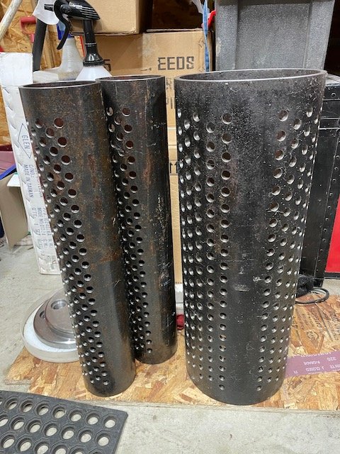

Added a bunch of air to two 4" tubes to make a pair of mud drums. Next comes comes some tube bending.

Where are you sourcing your roller from, and how are you configuring the 90° drive for it?

Roller is an E1 from Wicksteed in the UK https://wicksteed.com/wicksteed-product ... expanders/. Purchased extra mandrels as I expect I'll need to trim one to get it to fit into the mud drum.
Thinking of using an extended 1/4" drive, pneumatic ratchet. But that's TBD
