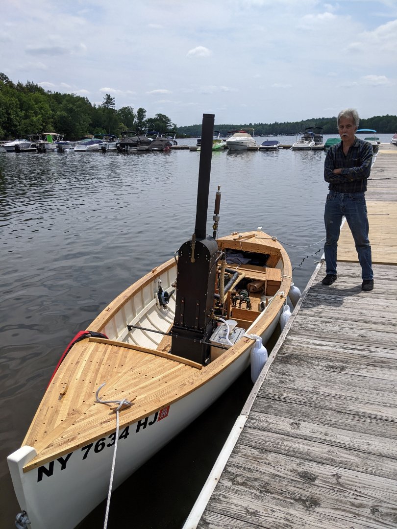

Launched my boat yesterday. It is assassin by Wes Farmer with a Hasbrouck #1 engine. My prop is a 12 x 12. 300rpm gives me 3 mph at 60-100 psi. 400 rpm gives me 4mph at 60-100 psi. 500rpm gives me no increase in speed. At 400 rpm I have to keep turning my steam nozzle (1/16 dia) off and on to keep the psi from going over 100psi. Most steamboats would have more pitch than I have. Am I being held back by my prop? My boiler is on the small size (9sq ft heating surface) , all copper, but seems adequate if I feed it good wood. If I need a prop can anyone recommend a source?

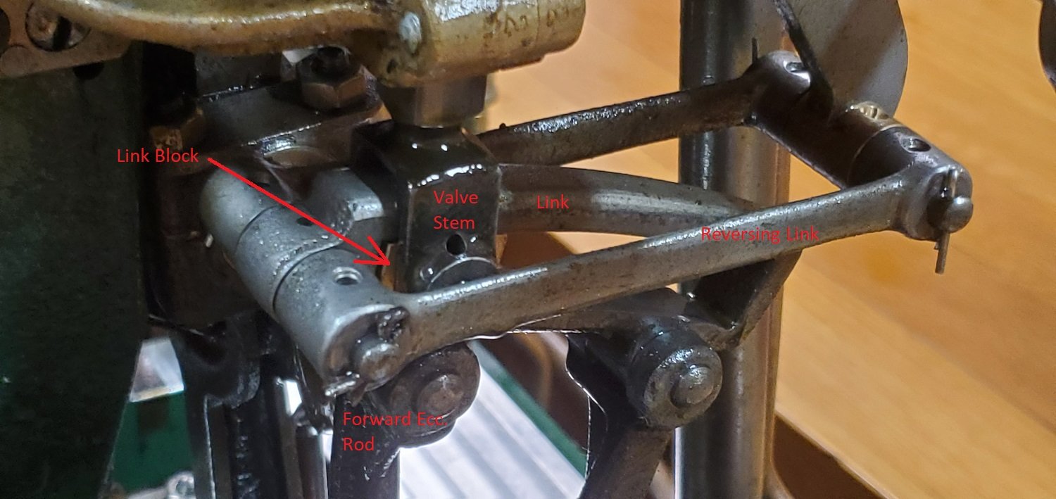

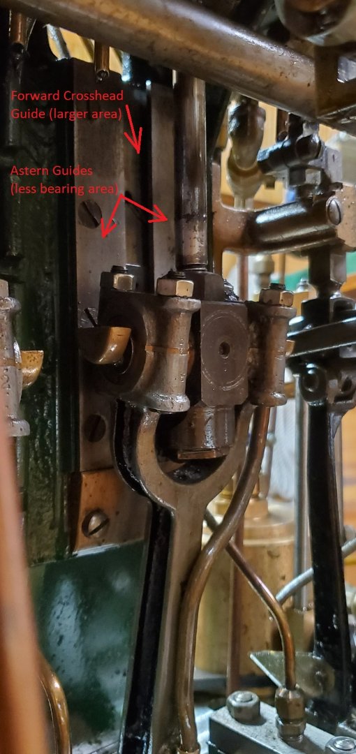

That depends on the engine. Many designs have a definite forward direction built in, and that should be respected. For example, some crossheads are designed with only half the bearing area when turning counterclockwise (when viewed from astern) as they do when turning clockwise.
Likewise, valve gear can have a definite forward direction built in. For example on Stephenson valve gear, where the the reversing links connect to one end of the link, then the valve gear should be set up with that end of the link as forward gear. The reason for that is that the link block slip is much less on that end compared to the other end, meaning that the valve events will be more accurate. Since the engine will spend 99% of its life going forward, it pays off to pay attention to that detail.
If your engine has equal crosshead bearing area in either direction, and valve gear that works equally well in either direction, then you are free to run rhe engine in either direction that is convenient.

In an edit to my post above, after rereading your first post saying that you have a Hasbrook #1 engine, and finding this video of it in operation, I'll modify my statement to say that the tunnel crosshead will allow the engine to run equally well in either direction. If it was mine, I would reset the eccentrics to have the forward motion end of the link timed to drive the engine in the opposite direction.
